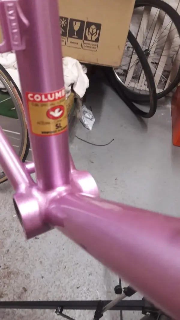

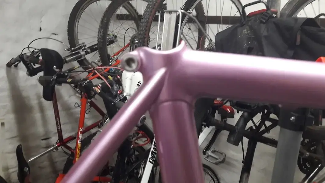

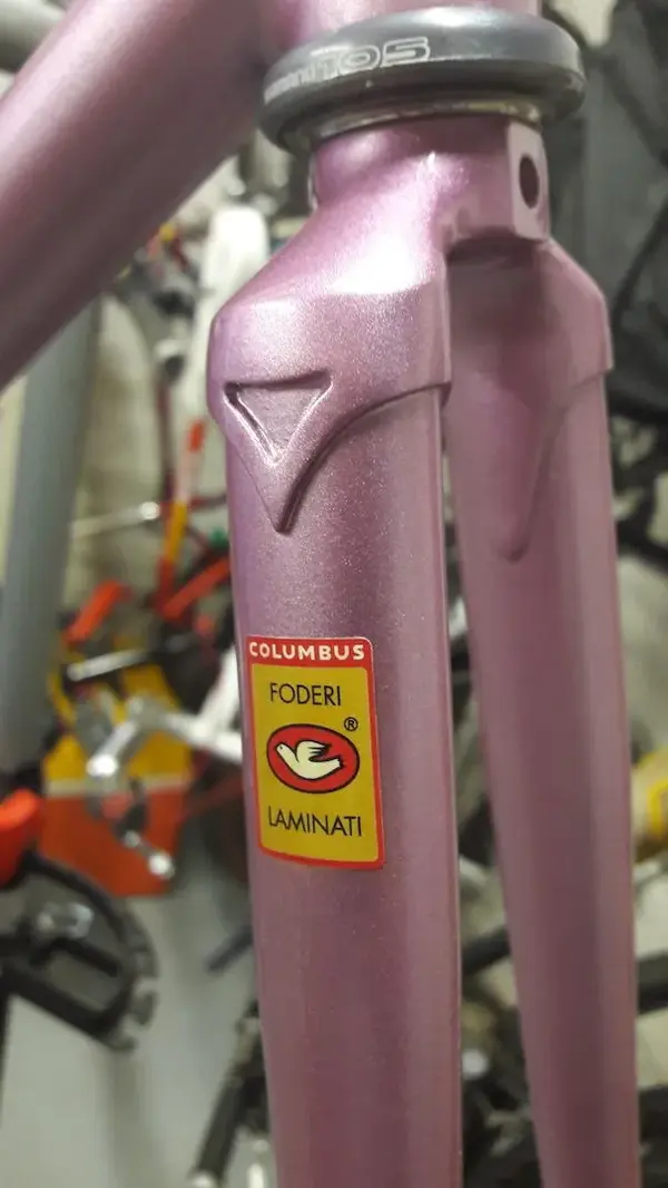

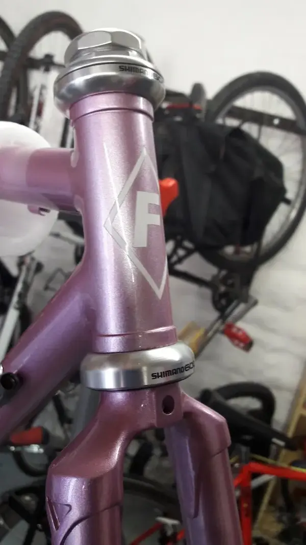

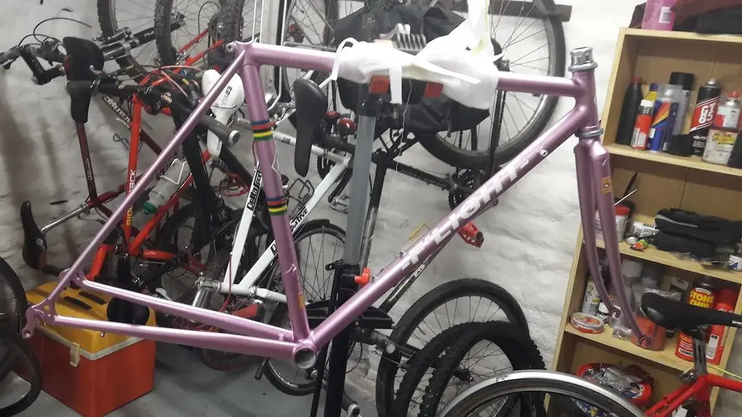

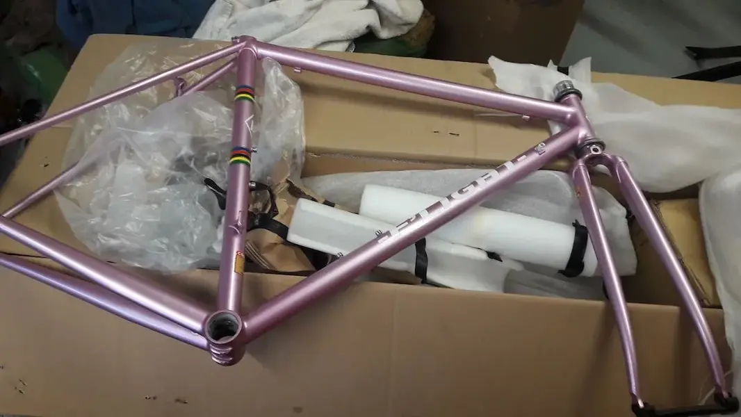

Here we have a new old stock classic road race frame, liveried as a 'F'light' (this was a brand from the shop Fairlight cycles in Devon).
The frame was built by legendary builder Ron Cooper and purchased with several other 'stock' frames by me from Ron in around 2006. It was painted metallic pink by colourtech which was next to Rons workshop.
It is 51cm from centre of Bottom bracket to top of seat tube and is made from Columbus sl tubing.
It is beautifully fillet brazed and has a BBB seatpost and a Shimano 105 headset included. 38" short wheelbase.

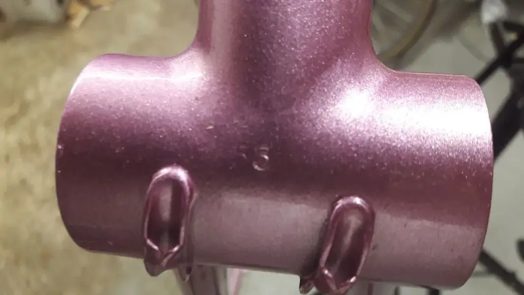

The paint on the top tube is slightly rough and there is a very tiny dent that is hard to photograph- you need to run your finger over it to really notice. This could easily be remedied if it was re-finished. There is a small chip on the down tube that has been touched in.
It is conventional geometry with horizontal top tube. It is close clearances with no provision for mudguards. It has all the usual braze ons inc. front mech boss and english thread bottom bracket obviously. 1" threaded fork. Rear end width is 130mm.
