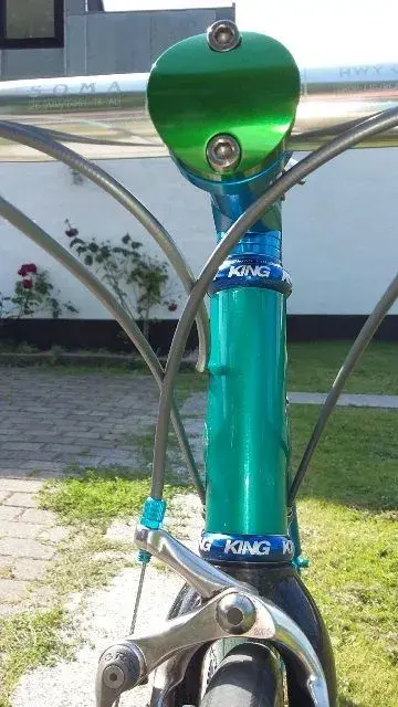

Stem: Ringle Zooka w/titanium hardware
Handlebar: Soma HighWayOne

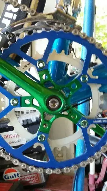

Cranks: Topline 110bcd
Chainrings: Middelburn 50t, blackburn 36t

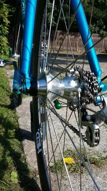

Hubs: Ringle Ti-Stix rebuild with 130mm SuperSuper8 130mm internals for the rear
Hub Skewers: Ringle twisters
Nipples: 16mm brass
Spokes: Titanium (non-drive side) revolution (drive side), Sapim Race (front)

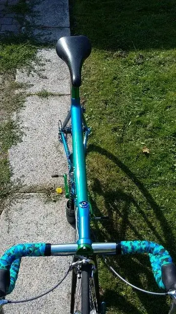

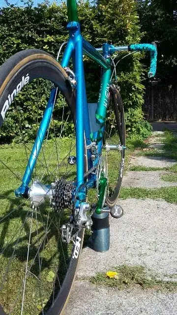

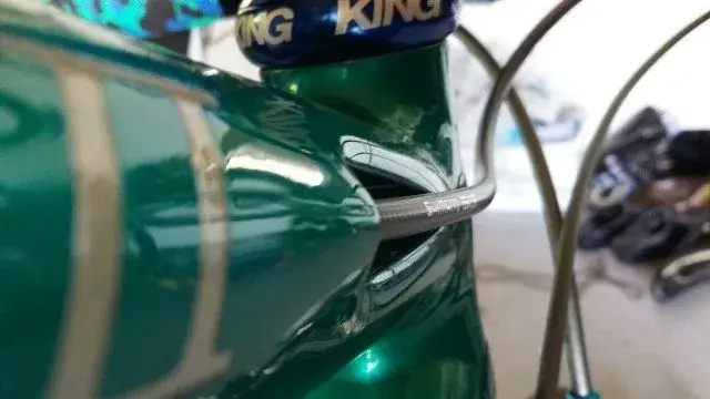

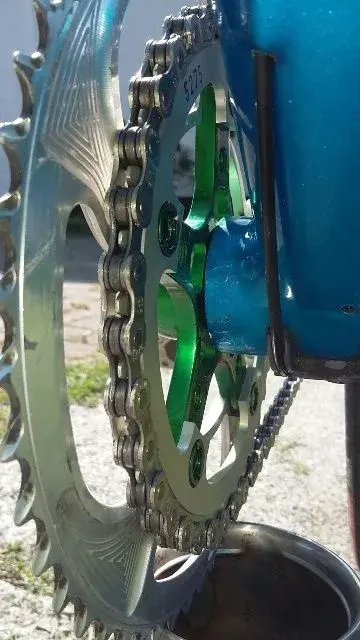

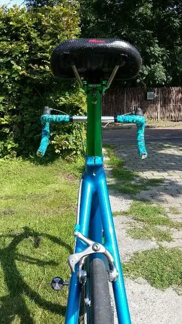

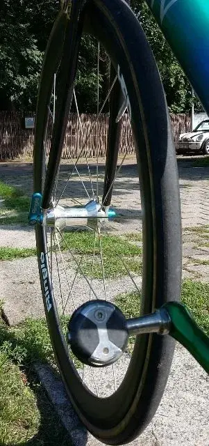

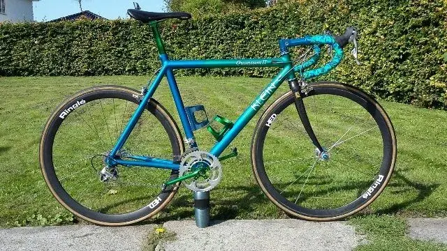

Ringle Ti-Stix wheels on HED rims! The coolest wheels known to mankind! I would kill for a set of those (in the 26" MTB flavor)...
These are not really HED rims. Got them made out east and then got Gil to make the stickers... not the real thing. But the look seems spot on. Rides well too
They might be even lighter than the original HED rims. I remember they were on the rather heavy side (the rims at least).
Fooled me looking at the pictures.... Still, cool wheels!
Thanks. Kind of all-in for the mid 90es stuff.
Would love to find some rings that were US made. The PMP rings that is on the larger pics is nice but very Italian. The Middelburn ring kind of off too becuase the bike is so non-Euro (for a road bike). But 110bcd 50t rings in Blue is not in plenty out there it seems
