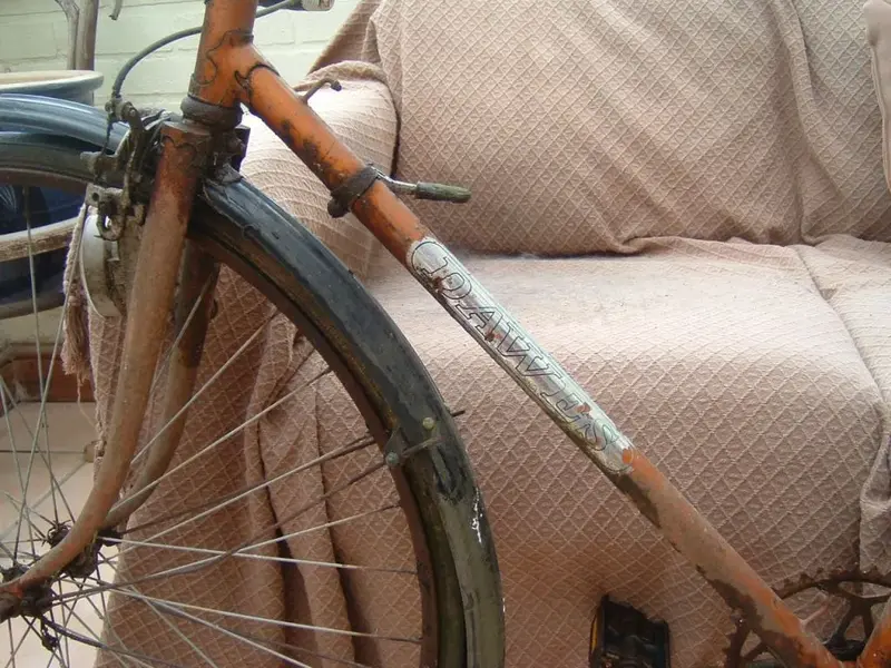

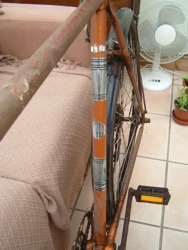

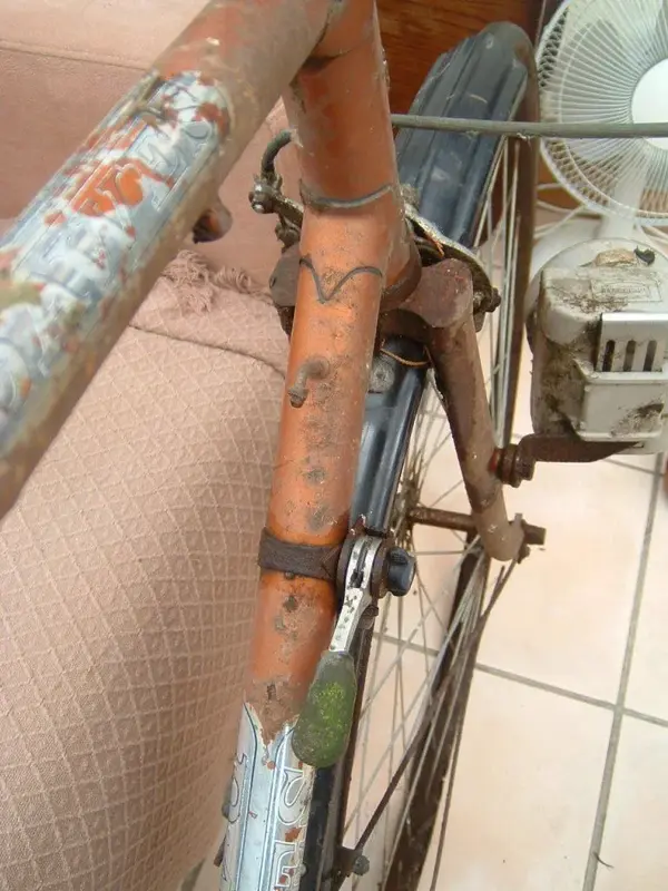

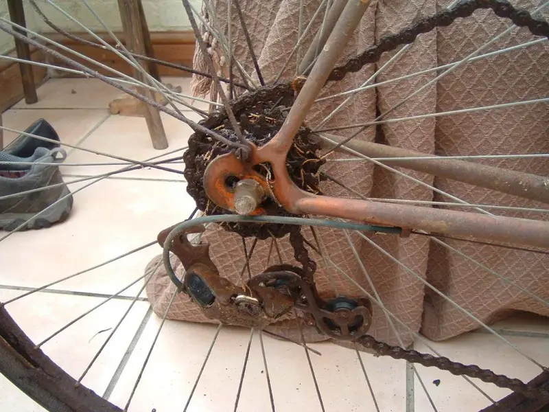

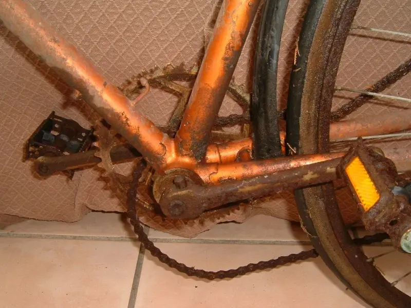

Hi,
Picked up this Dawes from someone who was going to skip it!
Not really sure what it is. He said he bought it in 1977 and last rode it in 1982.
It's not in the best of shape and I haven't started cleaning it yet. The rims have rusted through, but although the hubs are rusty, they spin very smoothly, which amazed me. Another plus is that the seatpost and stem move as well :-)
It's a 60cm frame and not overly heavy, it doesn't have a bolt on rear derailleur, but one that slots into the frame, but it does appear to be seized up.

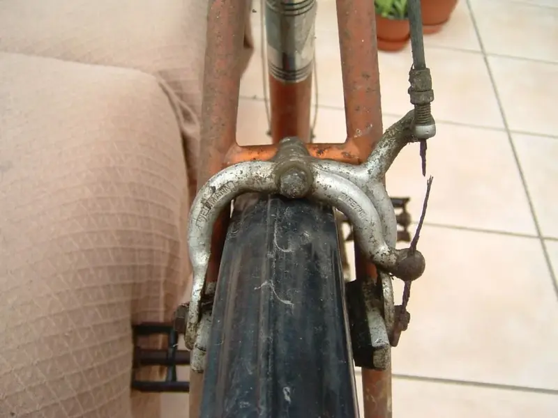

It has weinmann 730 brake calipers
Will this be worth doing something with?

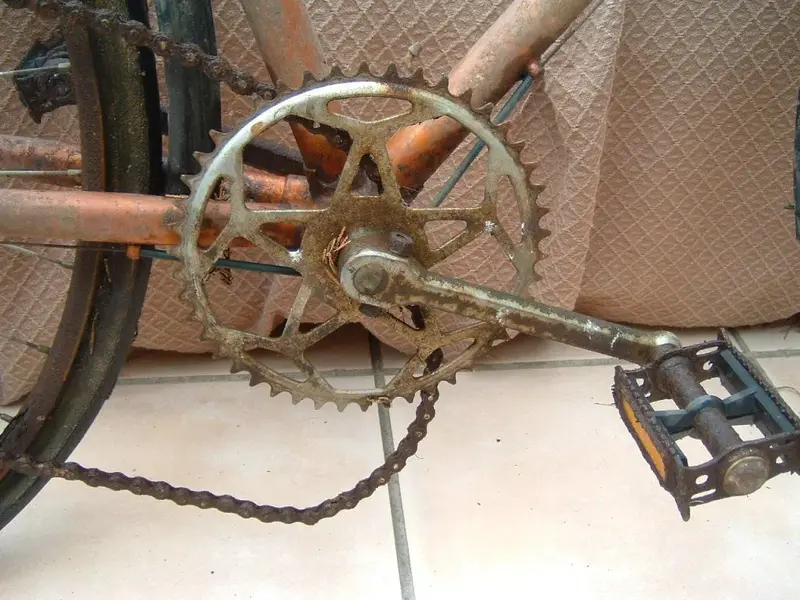

I don't really know much about removing cottered cranks, but I'd love and really appreciate some input from the experts in here.
Huge thanks
Rich :D

Looks like a tricky one ...
Have you seen the 1977 Dawes Catalogue here: http://bulgier.net/pics/bike/catalogs/ ?
The decals and headbadge seem to confer that this is a circa. 1977 model but I can't tell which one. There will be a date stamp on the back of the brake calipers. (circle of digits with a year in the centre).

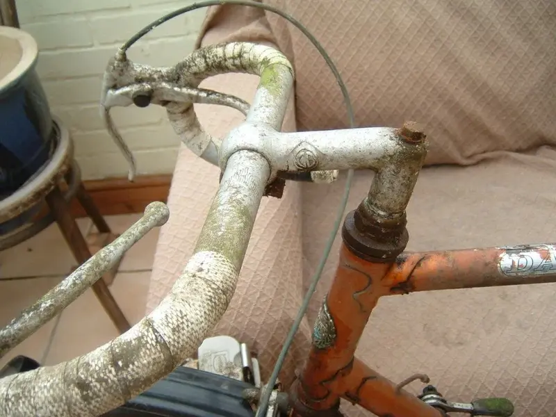

It has got a GB Neta stem which appears to have been fitted to the higher end models, but it has cottered cranks, which were fitted to the lower models.
The nearest model matching your bike I would say is the Chevron from the 1977 catalogue, but the colour doesn't fit. Maybe its a 1975 or 76 Chevron?
The mudguards look much older to me, maybe from a late 1950's/early 1960's bike, I think Bluemels guards were a different profile in the 70's.
Anyway thats my view, sorry if you are no wiser!
As to removing the cotter pins, I've had mixed fortunes with them, 3 out of 4 removed - 1 crank cut off with grinder, despite long soaks in WD40.
Bruce

Many thanks for that and a superb link to various Catalogue. I think you're right, it could be a chevron, but now I have quite a bit to go on.
I've found quite a bit of info about removing cotter pins, one including a vice and a large nut! also mentioned on the sheldon brown site is drilling them out. I will have aplay and let you know, as I've decided to strip the frame and go from there :-)
Huge thanks again
Richard :D

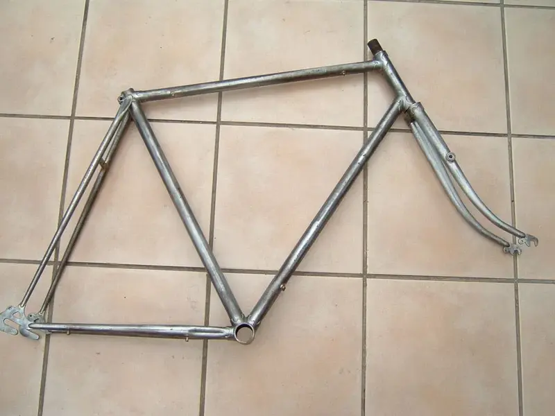

So, slight progress made in this project.

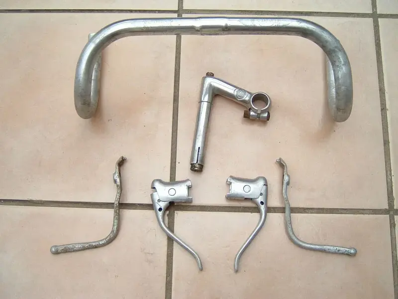

Had a few busy days recently, but had a day off today, so decided to to get to work on the paint and remove it from the frame. I found the best tool for this was an angle grinder equipped with a circular wire brush (wear goggles and ear muffs if you attempt this) Paint stripper wasn't up to the job as the paint was armor plated!
The Dawes bars are quite nice as is the GB stem. I will do a leather bar wrap in brown with green stitching I think.
The Wheels, freewheel,chain and brake calipers are toast :mrgreen:
I cut off the safety levers and saved the brakes that were on there. Since then I've bought some rather nice Drilled weinmann brake levers to use on the finished machine, and will search for some brown hoods.

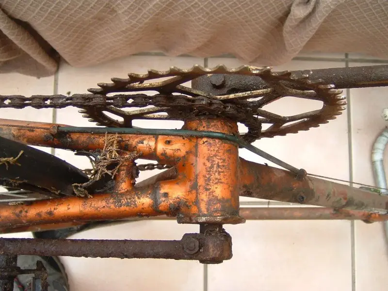

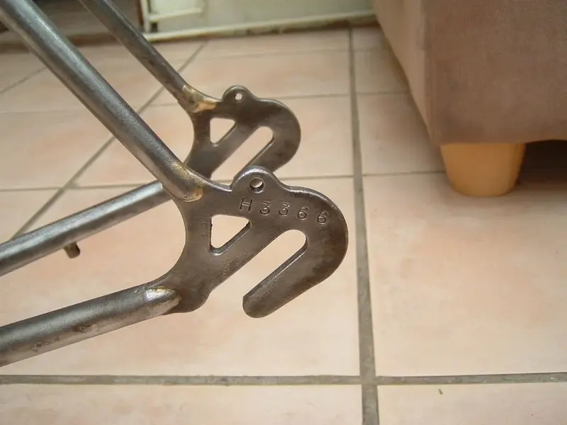

The serial number on the non drive side dropout is H3366. I'm not great with this thing and would gladly appreciate some advice if anyone knows
Pretty pleased with the frame. I will silver solder a few bits of rust pitting, with a propane torch and some flux and silver solder, then rub it down, then get it off for blasting and Powdercoating. I think I'm going to coat it in a nice Olive Green and line the lugs in either Brown or Gold :-)
Anyway, a few progress pics for you including the cranks that I cut off with my 9" angle grinder as after drilling the cotter pins out, the damn things still wouldn't budge.
Cheers
Rich
