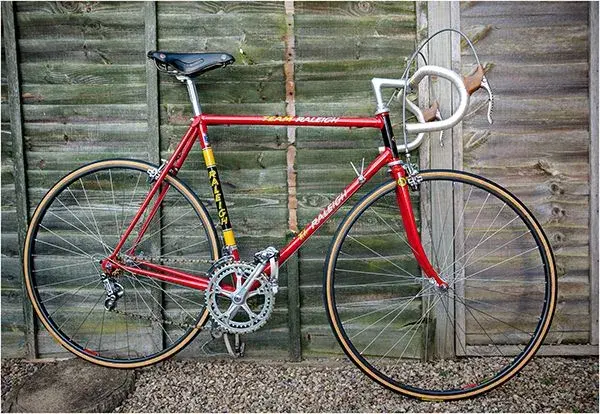

It's been a while (just over 2 years actually) since I first posted a build I was starting (viewtopic.php?f=23&t=197316). However, after all that time, that build is now complete. I finally built the front wheel today which means I've been able to stand the bike on its wheels for the first time.
Full Spec:
Most components are NOS. Where NOS was either impossible to find or price was just too high, mint condition unmarked used parts have been used.
1980 Raleigh Team Pro 753 57cm Frame and Forks SB4059

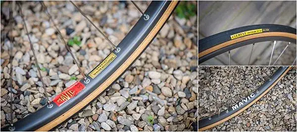

SBDU Standard spec for hubs/rims was 32H but sourcing NOS SSC rims was impossible. I finally found some NOS SSC but in 36H, so snapped them up.

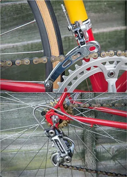

As the frame number is SB4059, dating to 1980, I tried to get as many Super record components from the same year. So any component with a PAT date mark had to be '80'. The very first component I bought for this bike was the NOS PAT 80 rear mech. It's complemented by the NOS front mech.

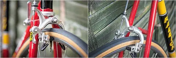

The stopping power is from a NOS Super Record brakeset which came complete with NOS genuine Campagnolo inners/outers.

Totally loved building this bike. Now I have another 6 months of looking at it until the good weather comes along again and I can ride it!

NOS Super Record Brake Set (Calipers, Levers, Cables)

NOS Mavic SSC 36H Rims
NOS Clement Criterium Seta Tubs

NOS Super Record Rear Mech (PAT80)
NOS Super Record Front Mech
