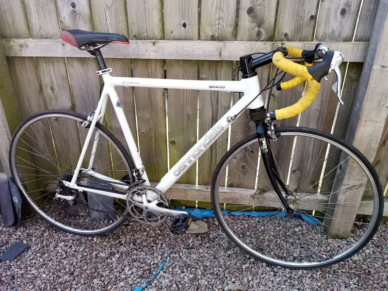

Time to start on this 'Dale project bike, unsure of the year? Edit: Date code on BB shows its a 1996 model.
It has a DD15 headshock to give a bit of comfort up front, it seems to work ok although there's a creaky spring in there somewhere, so a strip down and check might be a good idea.
The frame is in pretty good shape, save for a few areas of bubbling paint which seems to be the curse of Aluminium Cannondales.
Components are a mish mash of 105, Tiagra, 600, RSX, and Sora hubs on Mavic MA3 rims, combined with the cheapest looking tyres I've seen in a long time.
But amazingly everything seems to work together..
First job is a clean and de-gunge, and replace the bar tape and saddle...

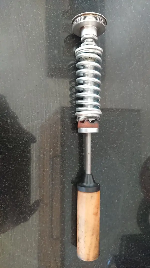

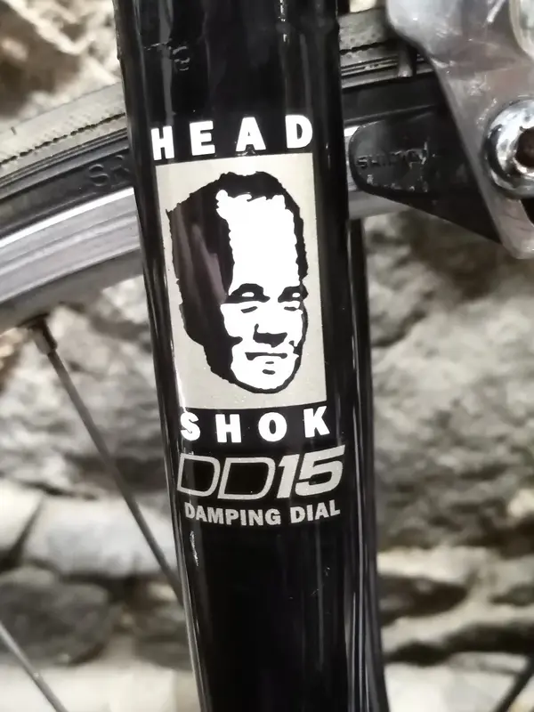

Took the headshock apart this afternoon.
The decal on the forks states "DD15 Headshock" which has a Hydraulic damping cartridge... What I found though was an SR Headshock, so just elastomer/spring.
As expected, the elastomers had compressed and become rock hard. Fortunately I had a couple of spare "Firm" Pace RC-35AB fork elastomers that were the same diameter, and with a few cuts of a Stanley knife I was able to fashion some replacement elastomers.
The roller bearings felt smooth so I left those alone for now.
A quick test and everything seems fine :D
Photo of the headshock with old elastomers (I forgot to take a photo of the replacements :facepalm:).

I changed the bar tape and saddle, and also fitted some tyres from a spare set of wheels, and set off on a ride this afternoon.
The Headshok did its thing, the only time I noticed it was a bit of bobbing from the front end when climbing out of the saddle, it's only 15mm of travel in any case, enough to soften the worst of the country roads (and the farm track I ended up having to go down :facepalm:).

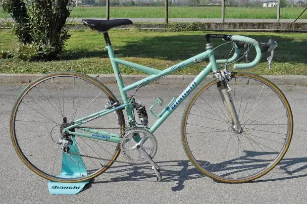

Never seen one of these before, and dont think i have seen another road bike with front suspension either. Are there others?
I ain't sure anyone else built in forks like Cannondale but Rock Shox had there Ruby girl which appeared on road bike around the mid-late '90's? It was a fad for the one day cobbled classics ie Paris-Robaiux. Only lasted a couple of years.
These were made from around 1994-2001 I believe, there have been loads of road bikes modified with suspension for the Paris-Roubaix and other cobbled Classics, eg the Rockshox Ruby fork, or the mental 1994 Bianchi full-suspension bike that Johan Museeuw rode (and broke).

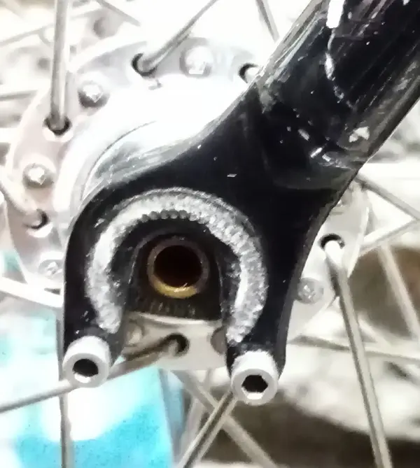

Can anyone tell me why there are these 2 bolts on the fork dropouts?
I assume they are like "lawyer tabs" and could be removed if required? (I think I'll just leave them there tbh).
Or are they for mudguard/ front rack??
