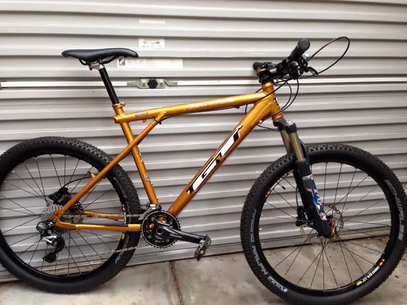

Hi guys, just finished a new build for my old GT Avalanche frame that I had sitting in the shed. Mix of second hand parts and new bits.
Does anyone know why this colour is so rare? I was told by my friend who I bought it from (who bought it new) that it was 1 of 3 of these gold frames in Australia. Does anyone know the story here??
Let me know what you think.
Fox 100RL 2006 model
DT Swiss Cerit Hubs
Mavic 819 Disc rims
Deore cranks 2x10 40-28t
SRAM Chain and Cassette 11-32
XTR Rear derailleur mid cage (just has sufficient range to cover the tooth numbers above)
XT Front derailleur
Deore Discs, with A2Z DM-Uni converter for the rear disc mount (only had V-Brake mounts)
XT Rotors, 180mm front / 160mm rear
Selle Italia X1 saddle - UPDATED Now a Selle Italia Prolink Gel Flow
Easton EC70 SL carbon bars
Thompson X4 70mm stem
Chris King headset (in matching gold... this was a bit of guesswork on the colour, I think it paid off!)
Schwalbe Racing Ralph 2.2 tyres
Looks smart. Headset and seapost clamp usually are in contrasting colour to frame but gold works here.
Actually the seatpost clamp is integrated- so painted with the frame- is this unusual? The headset was a bit of a risk, but I found a cheap used Chris King in good condition, so thought Id risk it.
True, I haven't cut them- same for the front one. I don't have a bleed kit so I cant chop them yet. Might go to the LBS.
Rides just as I remember- stiff, with good balance front to rear. Just a bit slacker than it originally was as its a 100mm fork vs the 75mm Z2 that it came with from the factory. Just means a little hop when doing tight switchback climbs

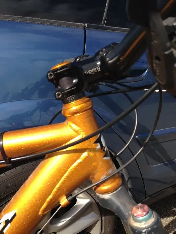

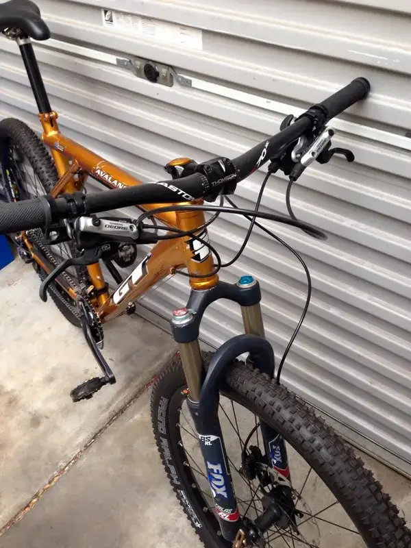

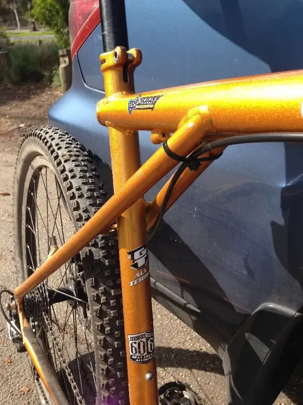

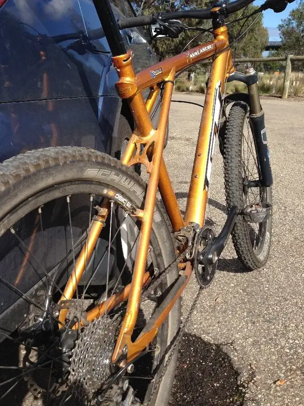

Hi guys, just took this rig for a cruise on the weekend. Unfortunately the trails sucked, but was once again happy with the bike. Haven't got around to resolving the brake line issue, but will soon.
Here are some more pics.
