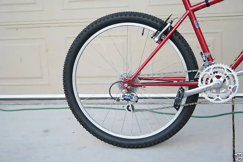

Dark grey was one of the colour options for the 94 Cinder Cones, so it could be a 94. UK 93 Cinder Cones were two-tone as Wu-Tangled says, but there was a US-only version that I think was grey. If you're unsure whether it's a 93 or a 94, one way to tell is whether it has a triangular hole in the dropout as below. They used those dropouts from 1990 to 1993.

it has a triangular hole in the dropout so it's a 93, funny you mention a US only version because i live in portugal so we were probably got the US version to because there was no autorized dealer at the time.

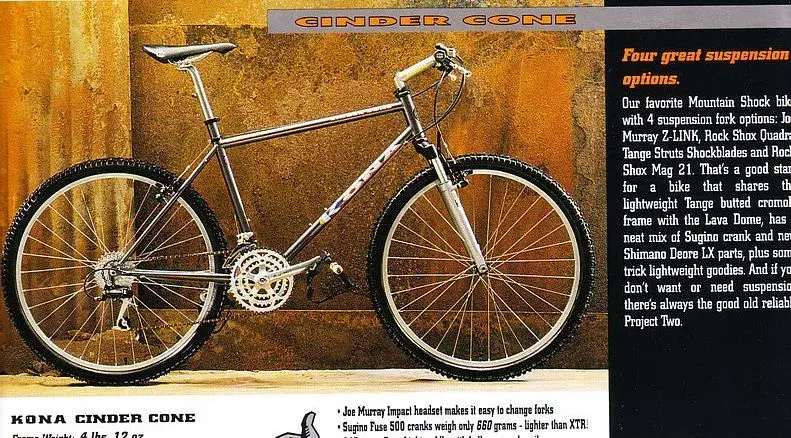

I understood it was north America only, but you could be right about Portugal getting them. The Cinder Cone page of the US 93 catalogue is below. I'm not sure, but it looks vaguely grey to me, or maybe silver.
fmarques25":26rh9jcp said:
A friend of mine said that the maximum size fork recomended for this frame is 80mm can you guys comfirm that, i have an old fork that is 100mm would like to use it...
Well the 93 frames weren't 'suspension-adjusted', so Kona would advise you to use only a short-travel fork - it was designed really for rigid, or at a pinch the early c50mm forks. You'll see it mentions Quadras and Mag 21s there, but even so they changed the geometry for 94 to properly accommodate suspension. I reckon you'd be ok with an early Z2 (65mm) or something like that though. And it's all a matter of taste anyway - whatever Kona say, some people run them with longer forks and like them like that.

that's it,it's kind of metallic grey, maybe mine was bought in the US i have no clue.
I've got it down to just the frame and the rust just looks superficial so good news there.
I'll try a old judy xc i can get for free and see how it looks.

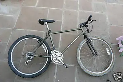

Thread hijack sorry lads ,,, my cindercone was a funny army green colour any clue of the year ???????
I don't know about funny, but army green reminds me of this one that was sold on eBay just a few days ago, did yours look like that? If so, it was a 1991. This colour never appeared in a Kona brochure, but I don't think it was all that uncommon for them to vary the colours in those days.
