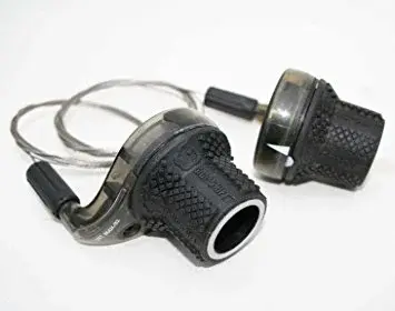

I've only ever used the 800-x-ray and the 600 versions I think.
The grips are different I know that, the lower models have a simple tube type grip and the gear numbers shown on the plastic twist part.
600...
800 (X-Ray)
Some of the cheaper models use horrible grub screws instead of clamps to attach to the bars which can ruin lightweight bars
