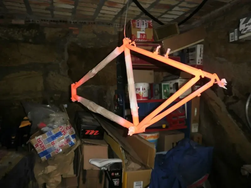

Marin team marin 1993 "Arturo rs edition"
Arthur rs
Red paint primer, then white colour for next better paiting of red phosphorescent, typical of eldridge grade model

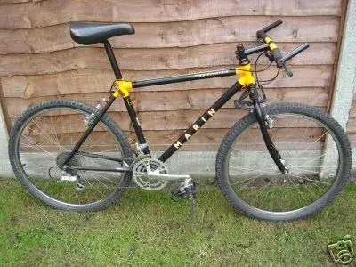

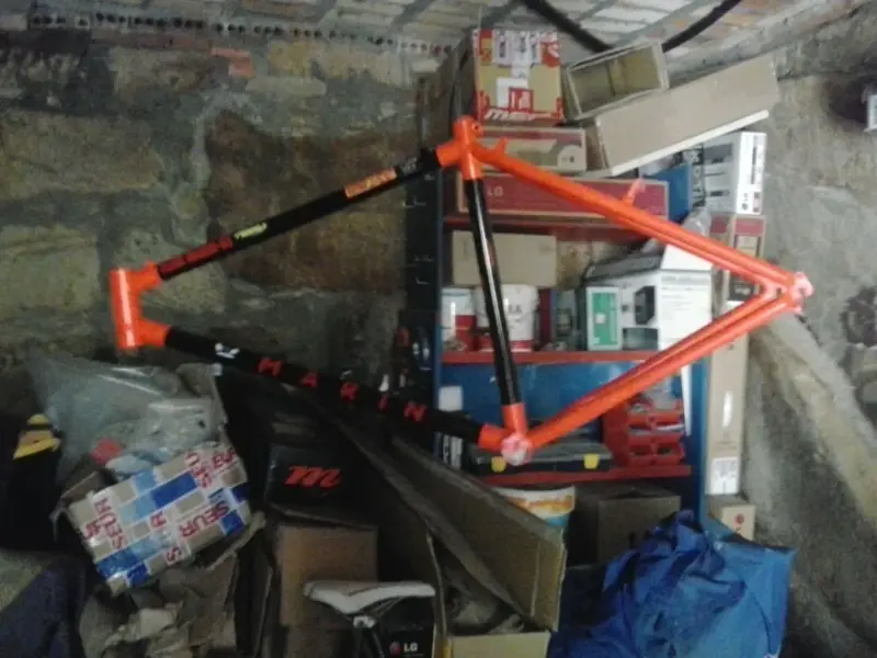

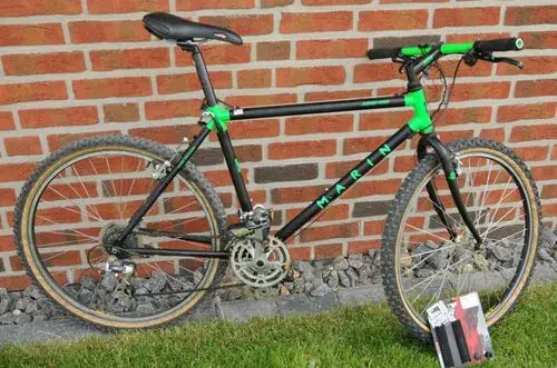

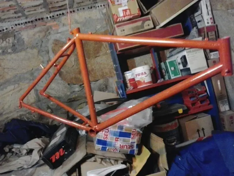

The 3 models i will inspirate are those.
I will paint stays like an eldridge grade, and ending of top&headset.. tube like those 2 models.
The reason of that colour is only because in painting store was the only one phosphorescent colour, and my intention is only to anyone who see that bike can guess is a marin, a 90,as marin. I will paint my "personal" way too, but not too diferent of 90,as marin.
I like the oem colour of that frame(1993), but is only a matter of nostalgia the reason for the selected colour&way of painting.

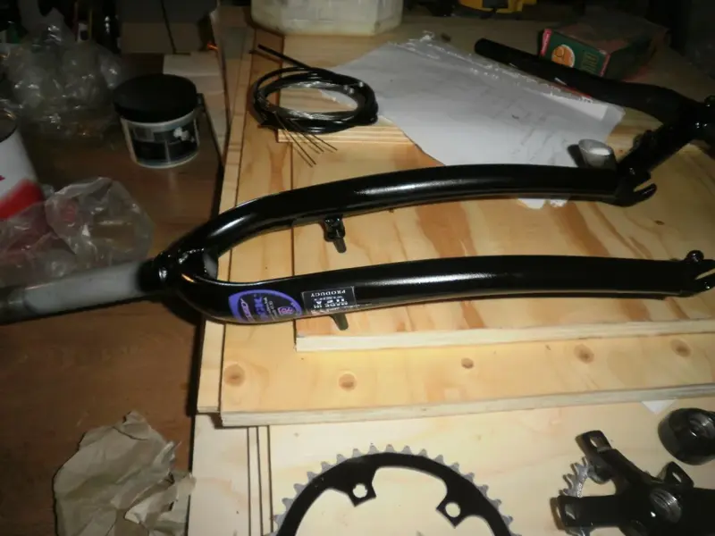

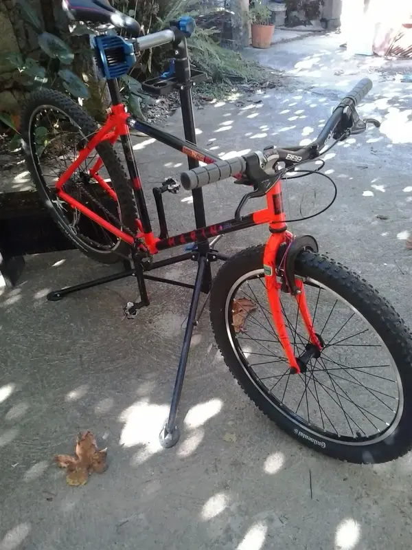

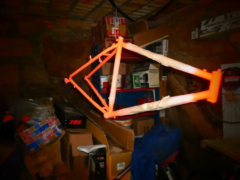

Some progress:

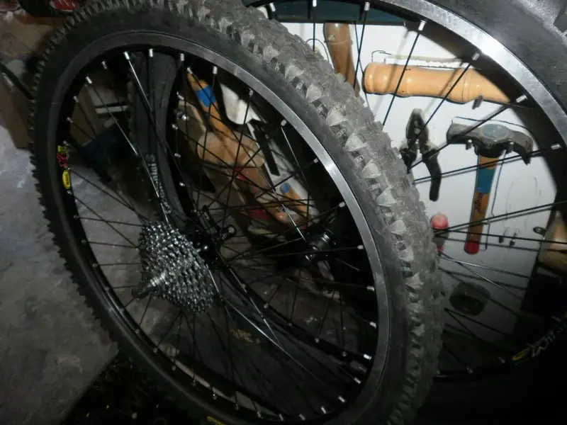

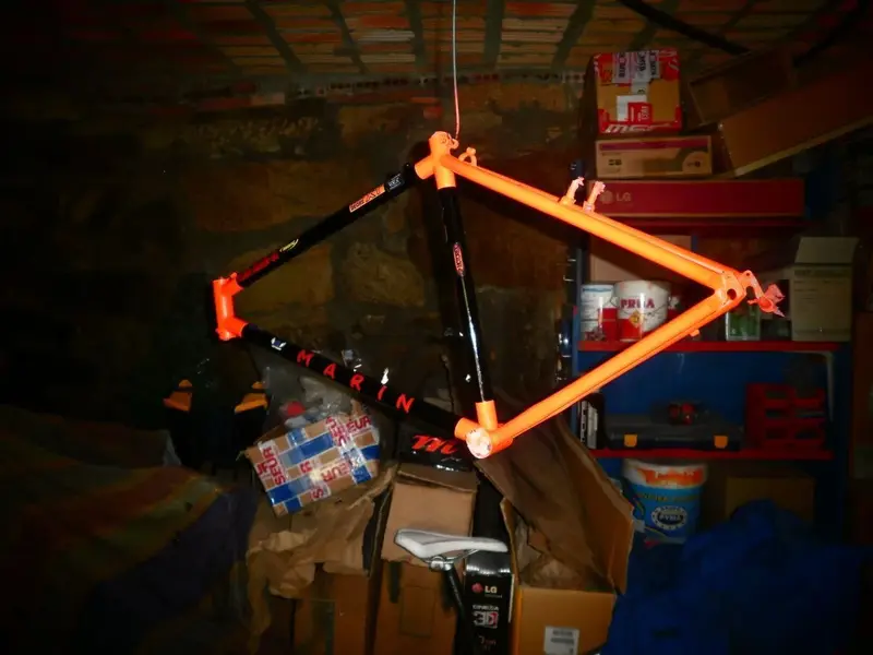

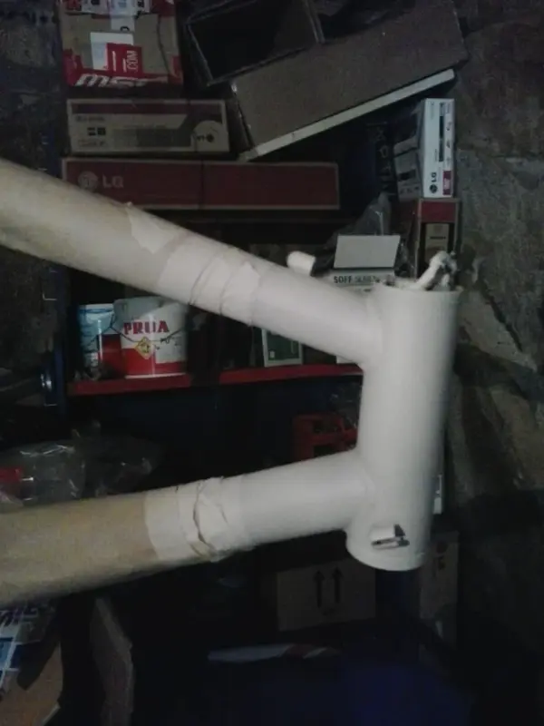

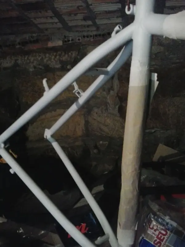

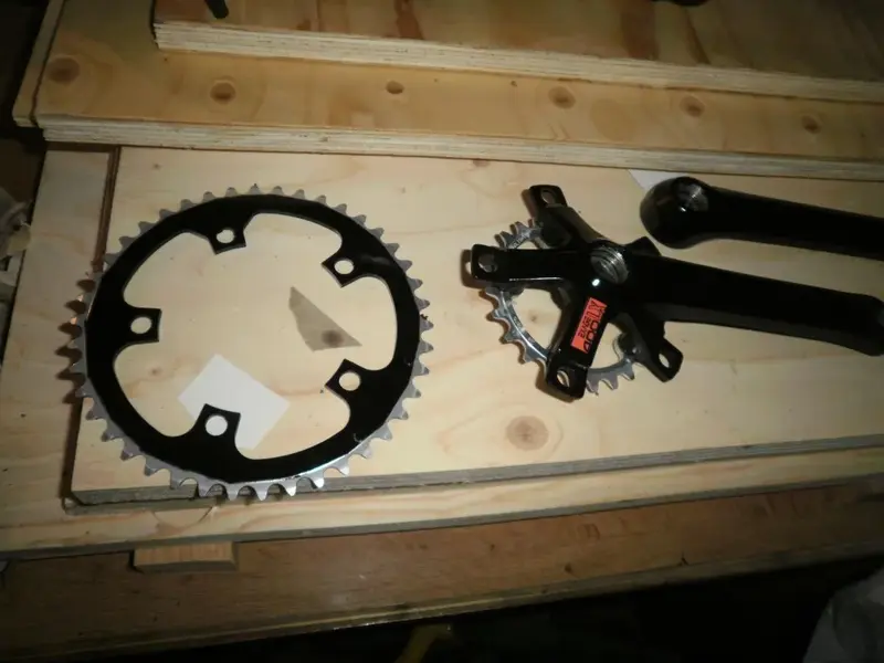

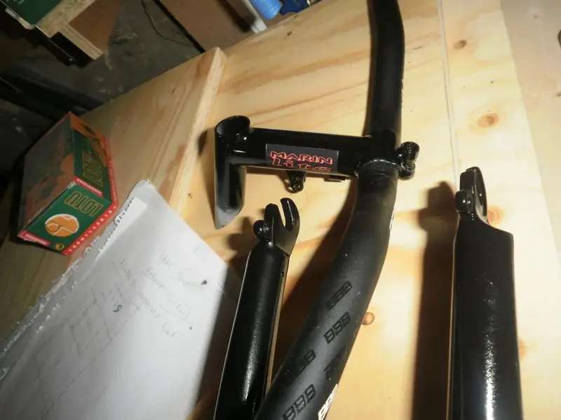

More progress:

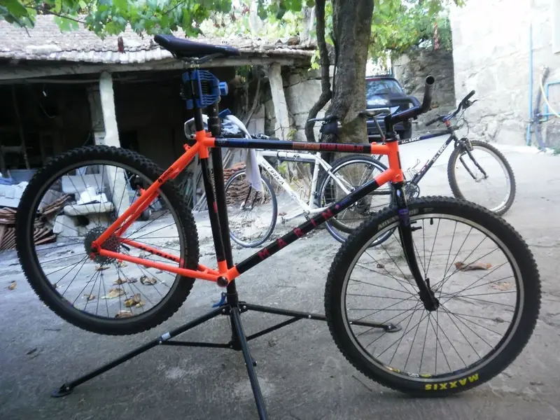

Updating, some more installed componentes and changed fork.

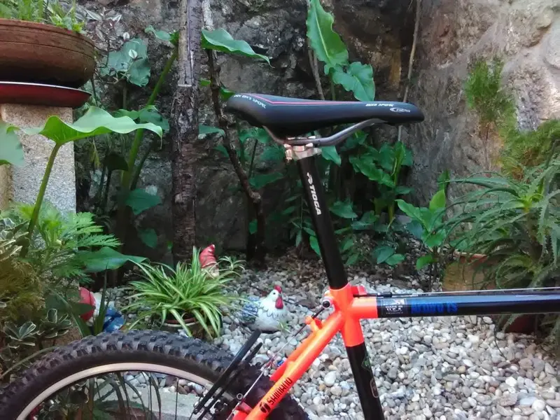

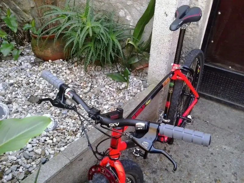

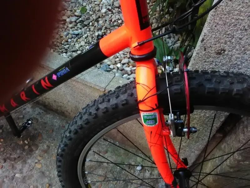

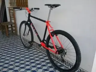

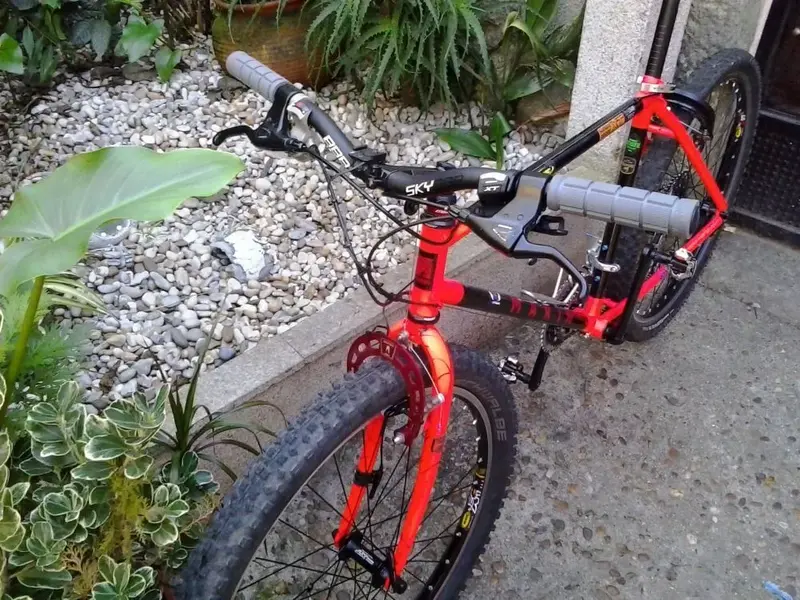

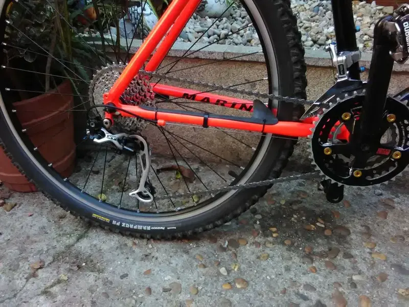

Final result:
Components
FRAME-Tange Ultimate superlight 2.080 kg 17.5" size.
FORK-Tange double butted 680 gr
HEDASET-Ritchey Logic
CRANKS-Shimano Exage 400 Lx-Al stronglight chairings&Brand-x Screws.
BOTTOM BRACKET-Shimano Alivio 122mm
CASETTE-Shimano HG-xt 11-34 - 9 speed
PEDALS-Shimano m520
CHAIN-Deore hg50.
FRONT DERAILLEUR-Shimano Deore dx
REAR DERAILLEUR-Shimano Deore xt
SHIFTERS-Shimano Deore XT 9x3v
BAR-BBB sky
GRIPS-Northshore
STEM-Marin lite 115mm
BRAKES-Shimano Deore Lx back-Dia compe front
BRAKE LEVERS-Shimano Xt servo wave plus.
FRONT HUB-Shimano Xt 32 s(Parallax)
BACK HUB-ShimanoDeore lx 36s(Black edition) Xt freewheel
RIMS-Mavic x717 Front, x317 back
SPOKES-Dt Champion
FRONT TIRE-Schwalbe Hans dampf 2.35 Performance
BACK TIRE-Panaracer Pr Rampage 2.10 T ready.
SADDLE-Ges mx3 sport
SEAT POST-Tioga
COLOUR-Marin Eldridge grade 1992 Arturo rs tuned.
