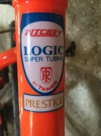

A few early '92 Orange Prestige have this decal :
Re: Re:
mechagouki":kb5vs3if said:
That's near identical to the one on my P23, which i guess makes it a 1991 or 1992 bike.
I bought the Orange new in March '92, and recall it'd been in the shop a month or so before that.
(I cycled in this bike to my GCSE exams - in May/June '92)
