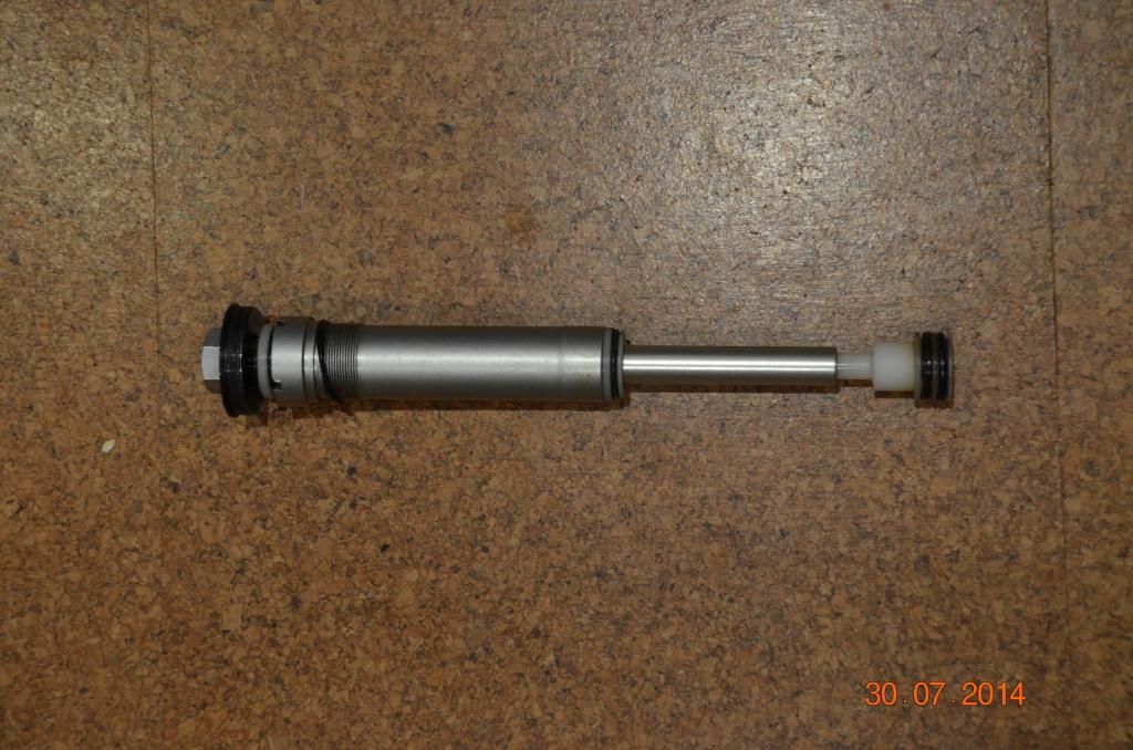

Hi I have been working on a Cannondale headshok. Bought it as scrap as I wanted the headset but I couldn't resist trying to get it working again. I have managed to get all the seals replaced with assistance of a break press at an engineering workshop. The needle bearings all in great condition and ready to go.
One dilema I have is that from the extensive reading up I have done some people say there should be a return coil spring on the air spring. I have found the cross section drawing from Cannondale and it does not show one and when I took the cartridge apart there was not one inside. The damper had signs of being removed in the past so it could be the spring had been removed
As I don't have a spring and can't source one I will put it together and see how it performs as it has only cost me a set of seals and some hydraulic oil.
What are other peopled experience. Is the return spring only in the upgraded damper which is still available for the DL80. Any thoughts.

I have a brand new, therefore unmolested, FT80 cartridge and it has a spring, orange I think, with an thin elastomer inside it on shock shaft. The elastomer might be to stop spring rattling about. I assume the FT80 is later than the DL70.

I have just remeasured the forks and they actually have 80mm of travel rather than 70mm as previously mis-measured. The cartridge looks more like the drawing of the DL80 in that it has a bleed screw. The parts diagram does not show the return spring but when you look at the PDF drawing below there is a return spring shown on that parts diagram.

I have sourced another set of forks that I think have the same cartridge in them which are working and I will open them up to confirm if they have a spring. Waiting on the correct castle tool to arrive before I dismantle the new set.
Just to close this out myself. It did in fact have a return spring. It had gone missing during the dismantling of the damper. Careless I know... :roll:. Anyway put the damper back together a few months back and it is working great. Working on a lefty now....
