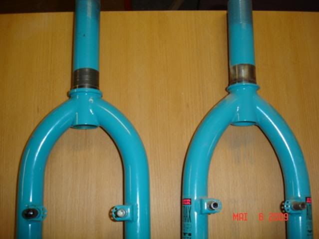

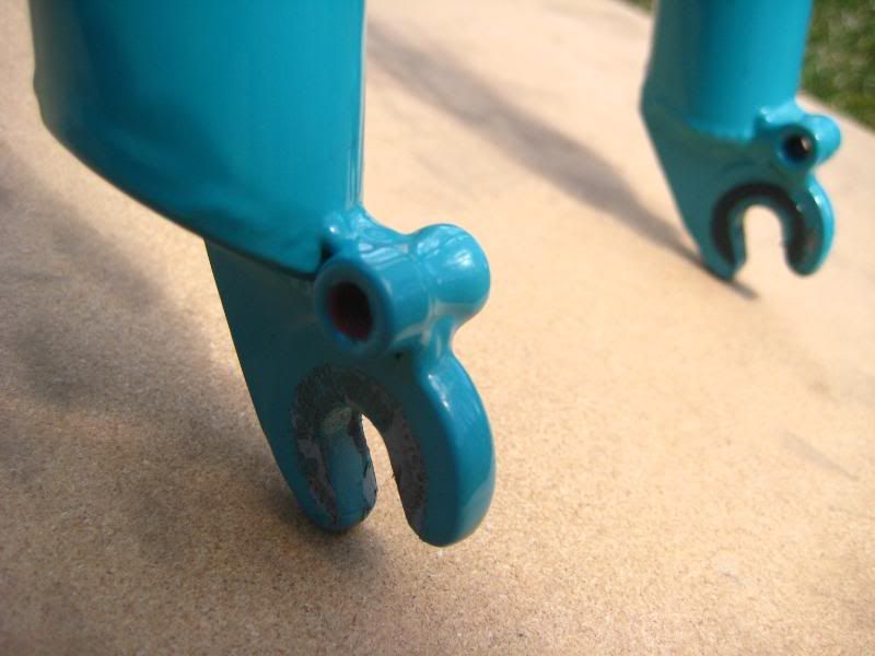

The "Yeti" fork had a shallow-er fork leg bend and Campy dropouts.
Disregard the decal placement on this, but here is a good photo of the difference. Yeti fork right, Answer Accutrax left
Campy drops
The rub is that a lot of post-license forks were made by Yeti, some with wide bends, some with shallow bends. For example, I've owned "shallow-bend" forks with laser-cut dropouts. So the only real way to tell if it's a pre-license fork is the campy dropouts. The picture above is an accutrax.
Campy drops
Hi Mike,
Thank you very much for the above, brilliant picture's.., and very nice to hear some info coming from durango :)
I wish i knew more about this bike.., after looking at all the design changes, and when they accured, i can only assume that this is a 1990 model like my ultimate...
