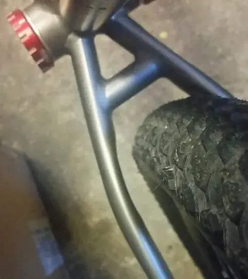

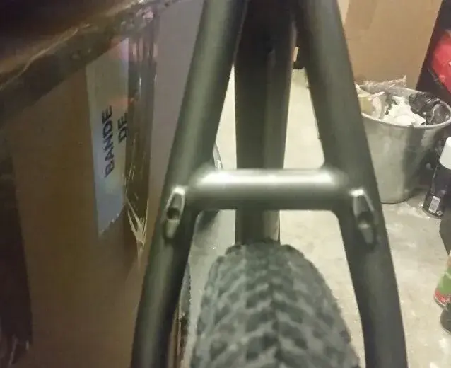

Without moving the drop outs, I spotted in some 27.5 wheels wearing some 2.0 tyres. The results pictured below.
Looks like things will be fine. I've got some 2.35 tyres to fit, how much extra meat will they have, and will I be able to get away with fitting them without moving the drop outs, or should I move them rearward for some extra clearance?

Looking good. The clearance with the bigger tyres wont make a lot of difference but I like a short rear end on mine so might be worth a ride before you decide on final placement. Did you decide on a wheelset?

Looks fine to me. How about the front?
