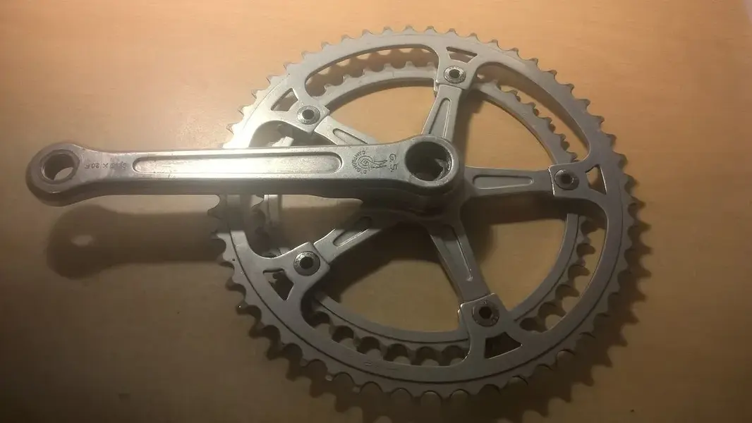

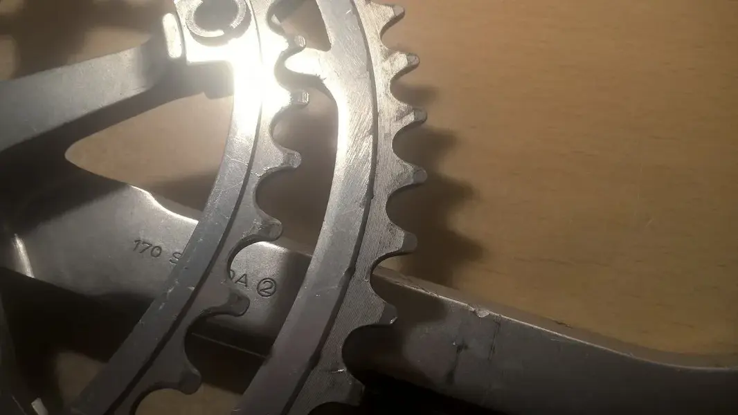

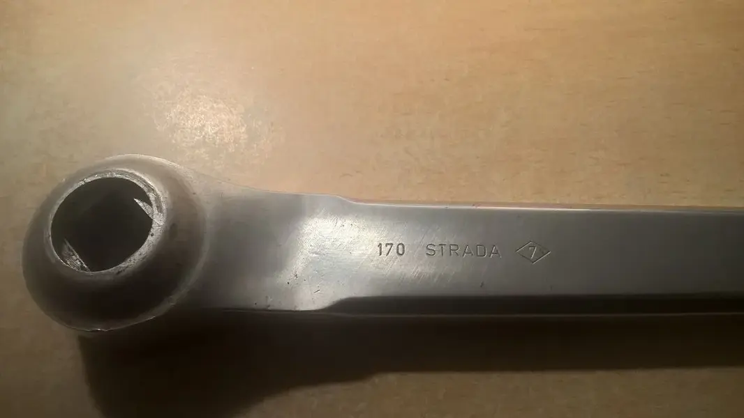

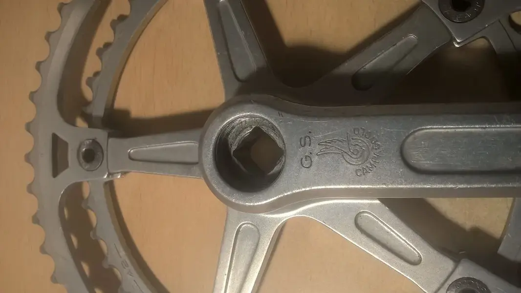

I have this Chainset 52/42 non campagnolo rings
I realise it is 170mm
I remember buying the left hand crank separately from Whiskers in the Kilburn shop in late 80's.

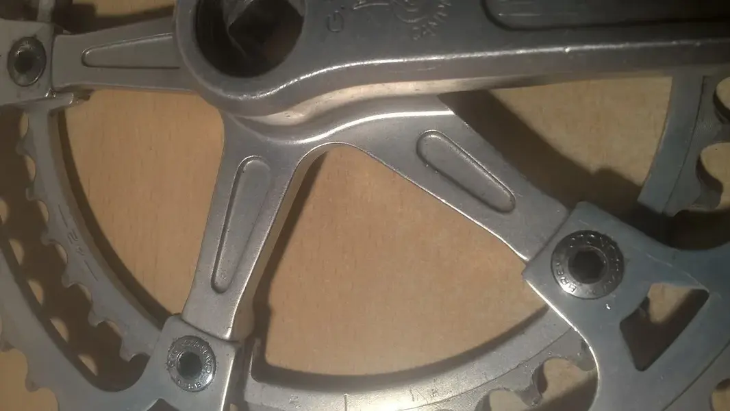

any thoughts on which level the cranks are?
I assume GS on R/H side is for Gran Sport.
I can't see me needing them for anything.

Thank you that is very helpful.

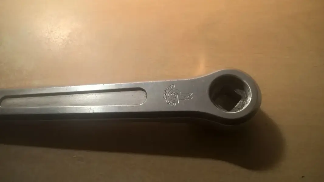

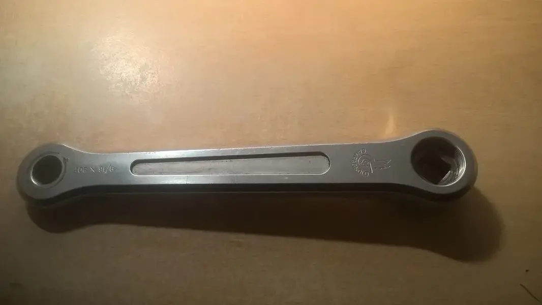

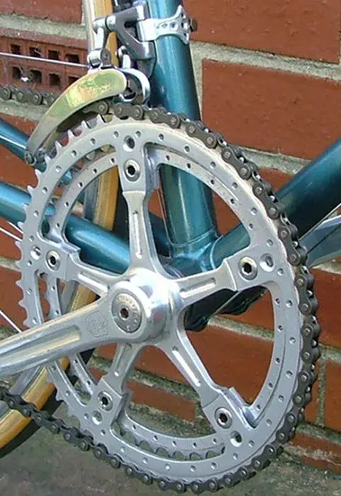

They are not a pair.
The L/H I got from Whiskers is the bit I cant remember which group it was.
Any thoughts of how to identify the L/H (not marked GS)?
