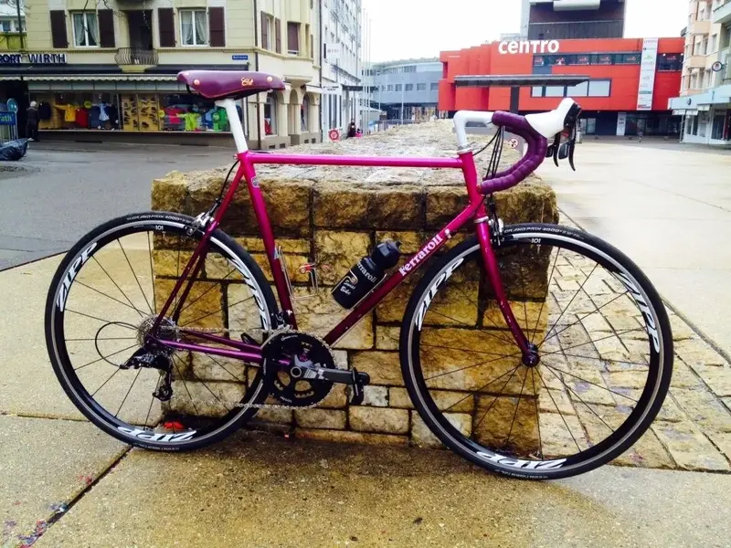

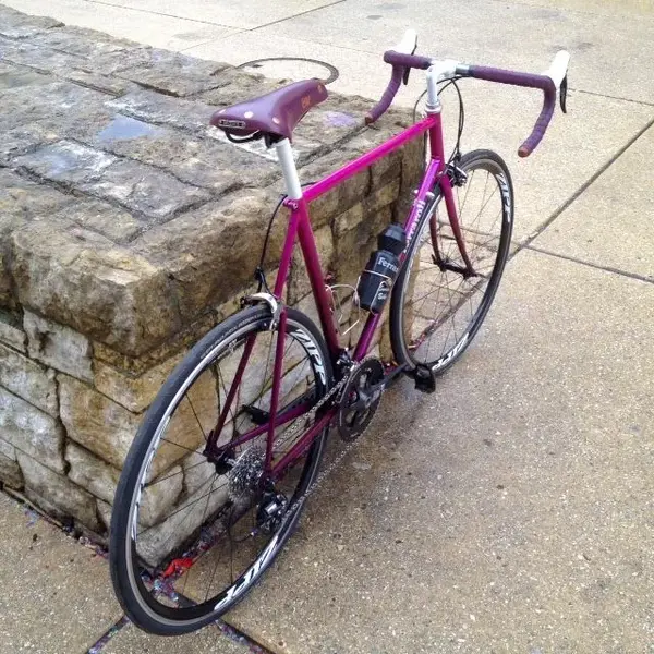

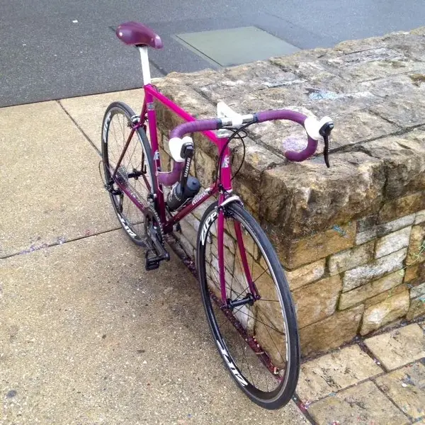

Here are a couple of quick snaps of my latest project; this time, it's a neo-retro/resto-mod build with modern parts on a classic frame. I believe the frame and fork are either a Simpatico or a Grazioso, but as with so many Ferrarolis, the small, over-clear-coat model name sticker has been lost over the years. I am only waiting for a pair of Continental Grand Prix Classic tires with brown sidewalls to complete it to my satisfaction.

I quite like this neo retro build :cool:
but have just "reservation" about the saddle , which is quite bulky and the white seatpost and stem
Think it spoils a bit the sleekness of the bike with this so lovely rear seatstay :idea:

Thanks for your comments. I spent a lot of time thinking about the seat post and stem on this build before going ahead with white.
My first choice would have been a shiny grey anodized finish to match the 3T bars and TRP brake arms. Unfortunately, since this is a Japanese-brazed frame with seat tube inner diameter of only 26.8mm, my choices of quality seat posts in this size were very limited. When I found the 26.8mm NOS/NIB American Classic post in white on eBay, I knew I could do something special with it.
Visually, I like how the hard transition to white clearly divides the magenta upper frame from the violet saddle and bar tape. That having been said, I was heavily involved in the graphic design process at BMC for five years, so my eye is quite accustomed to hard transitions between contrasting colors.
Without the white sharply separating the colors, it might look as if I tried to match the upper frame' paint color and failed. With it, one's eye drifts lower to find a repeat of the violet color within the gradient fade.
I don't normally ride Brooks saddles, but really love the way this leather color works with this frame. Once the weather and road conditions improve, and I am lucky enough to sit on the bike for more than a few minutes at a time, at least you won't be able to see the bulky saddle so much!

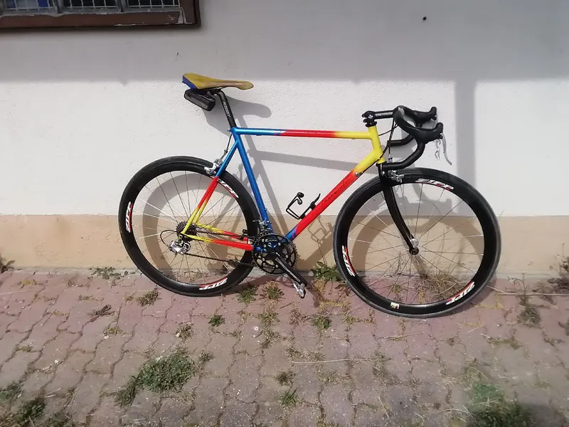

C'est quel année c'est vélo ? La marque est ferraroli. Merci de votre réponse

Bonjour Bessa,
Les couleurs de peinture et les lettres utilisées pour les logos indiquent que ce cadre a été fabriqué vers la fin de Cycles Ferraroli SA, probablement entre 1996 et 1998.

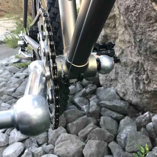

Recherchez le numéro de série estampé sur la boîte de pédalier. Sur la plupart des Ferrarolis construits dans les années 90, il y a normalement un chiffre orienté à 90 degrés qui indique l'année de production, avant les chiffres suivants qui représentent la séquence des cadres construits au cours de cette année. Par exemple, le vélo de mon fils ci-dessous est le 1728ème Ferraroli construit en 1992.
