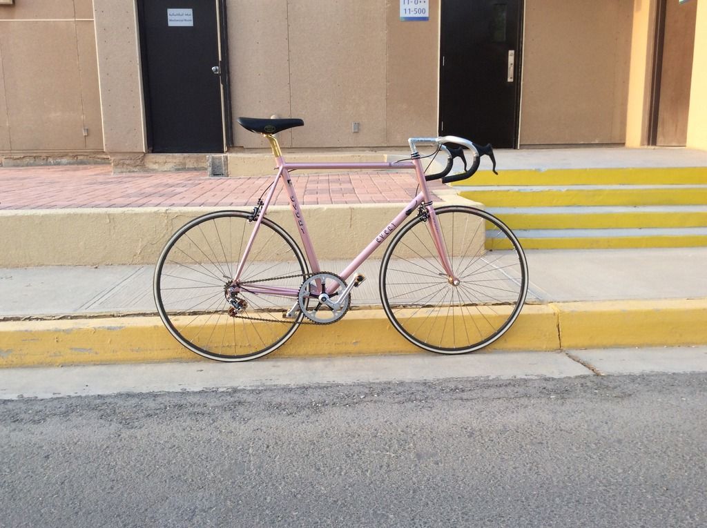

The bike is pretty as a picture, and the story is also good.
So many questions though. Would love to read more of a build thread on it. ;)
Yes I can add to this thread the build which took 11 months to complete
Yes Ian actually use a double radial rear wheel.
The Build Sheet
23 3/4" Every Frame built by Argos based on measurements given by Colin Every original Builder
Wheels: 28/28 CX-18 Mavic rims on Mavic 550 rear Hub, Mavic front Hub 80mm width (Both hubs - ceramic bearings installed) Spokes Saipam Ovals
Tubular Tyres: Dugast Piste 18mm Silks
Freewheel: 12-17 6 speed Maillard Dural block
Chain: Everest Oro Gold Slotted
Rear Mech: Mavic 501 (customized)
Crankset: PMP 177.5's (Ian Record breaking Originals)
Chainring: 56T custom carbon ring from Fiberlyte
Pedals: Cinelli M71's (Ceramic Bearings installed)
Gear Lever: Kronos (Ian had this as his original but broke it!)
Brake Calipers: Modolo Speedy
Brake Levers: Modolo Kronos
Bars: Cinelli Champion De Monde 64-44cm
Stem: Cinelli 1R 130mm Stem
Cables: Clarks
Bar Tape: Black Cloth Tressorex Tape
Bar End: Cinelli
Saddle: Cinelli Unicanitor
Bottom Bracket: Tifosi 111m steel axle cartridge
Seatpost: Columbus Air 24k gold plated
