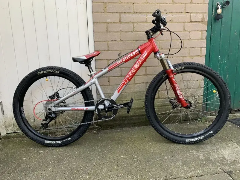

Trek MT 220 build for the boy šŸ‘¦šŸ¼
All theā€¦.small thingsā€¦.!
Itā€™s getting there, the crank situation isnā€™t resolving itself anytime soon, so just hoping his legs can push these round for a little while. Lovely little bit of xlite bling from @markoc sets off the back end nicely.
Next jobsā€¦.Red hose for the brakes and some proper guides to keep it attached.

Well, I expected that 165mm was going to be too long. I keep umming and ahhing on these in 150mm.
I may modify some RF evolve xc cranks to around 150
Gearing at the back is m770 9sp max 32t
Deore shifter and mech
Front will likely be 30-34t
I should add that itā€™s not finished yet. He may hate it :-/

Just to me, it looks a bit from the side that the length of the bomber is a bit too much.
Ideally the bottom bracket height should be lower than height of the axes (modern kids Bikes using 29er principles and have a sometimes several inches lower bottom bracket, sure, only in combination with short cranks).
With a too long fork not just height from front and bar and also a bit the bottom bracket raises, also the center of gravity goes up and back. In conjunction with often needed short stem, there isn't a lot of weight on the front anymore and a loss of traction and steering guidance.
Don't want to paint it black, but just emphasize to keep on eye on the fork length.

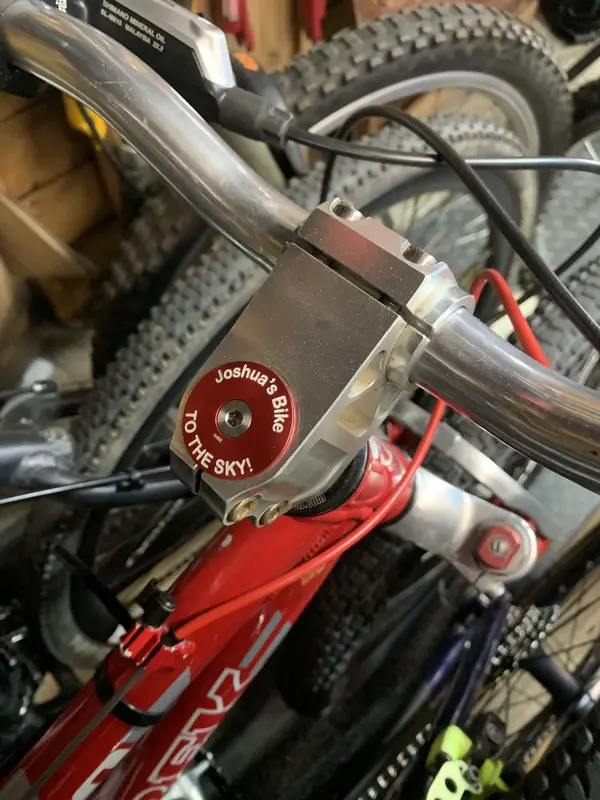

If anyone knows the chap that runs Kapz youā€™ll know heā€™s had an eventful and quite incredible time helping out with the Ukrainian humanitarian crisis. Any way this is a custom stem cap from Kapz with a well known YouTubers motto which josh particularly enjoys. Still need to sort those shorter cranks out thoughā€¦..
