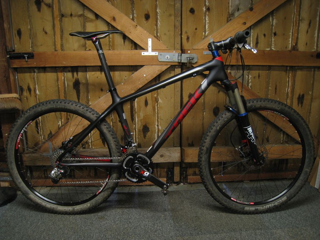

Wads has been busy.....
The Elite is now ready for a test ride ;)
And yes, the blue headset spacers are temporary!

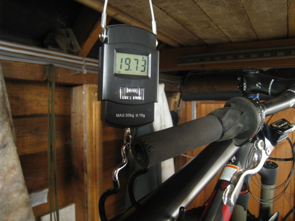

Just under 20lb ;)

superlative!
I've always loved the 26"xc-race with "fat" tire...
with less spacers under the stem it probably looks so damny race, but probably too uncomfortable...
amazing bike!
26arentdead!
