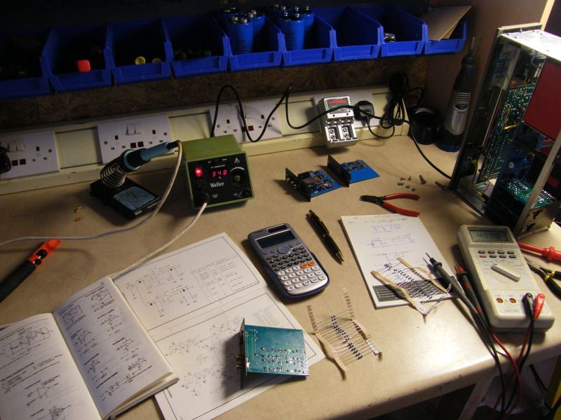

Here we go...
First up, reduction of gain of the Aux input. The gain is 1.6 as standard on both the Aux and Radio cards, but the Aux card differs in having a voltage divider on the input (roughly 4:1) possibly as a mod for CD players coming out back then? Anyway, I reconfigured the gain to unity so now it's merely a buffer. While I was in there, I figured I'd swap all of the old 5% carbon resistors for 1% metal film (matched by hand for good channel matching). Don't have any top notch single op-amps in at the mo, so didn't change / bypass any caps until I change the op-amps and null any DC offset.
Next up was that balance control, I've bypassed it until I find a replacement, and while I had access to the main board, I swapped out all the old electrolytics for new Silmics (decent, but not stupid cost).
I think the muting relay is getting a bit lazy as one channel stayed off for a few seconds... That's for another day.
