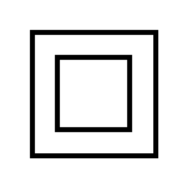

There should be a label with manufacturer and power rating details somewhere on the amp, if it is 'Class 2' (double insulated and not requiring an earth connection) it should have this mark on it.

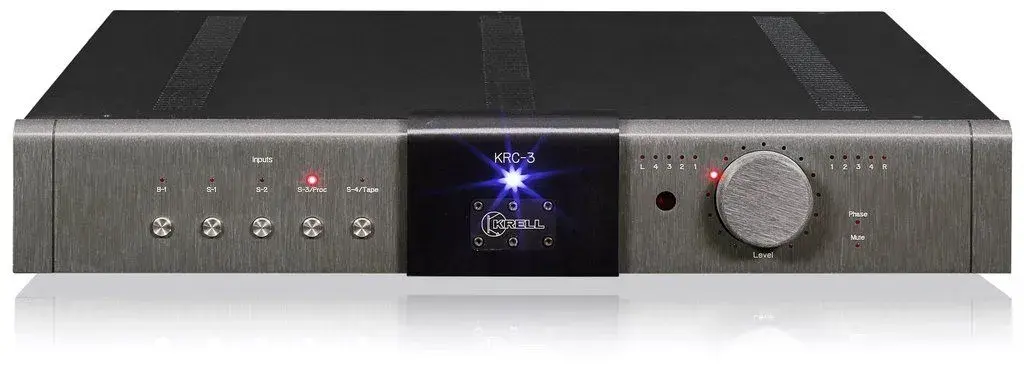

Slept on it (not physically) and I'm not happy about this so it's going back... decision made :cool:
Found a KRC-3 instead (with the earth wire connected ;) ) so we'll see how that works out instead! :roll:
Got a fantastic response from Krell, great that they even bothered to reply, that gets a big thumbs up from me:
Hi Mike,
Funny what you can still learn about an older product today. I am told that the AC receptacle is a PC mount version (I knew this part) and that one of the pins that connects this receptacle to the main circuit board act as the earth connection. This is connected to the chassis through the PC board and one of the standoffs (connecting hardware) that connects the circuit board to the bottom chassis (I did not know this part). The vacant lug on the back of the AC receptacle is a redundant earth connection. The KSL (as well as all of our other products) is a Class I apparatus and requires the earth ground connection from the power cord, which then goes through the PC mounted pin via the AC receptacle. Meaning that the AC receptacle does not require an additional connection to the vacant lug on the back of the AC receptacle. We are at a loss to explain why the fuse blows when a wire is connected to this redundant lug on the AC receptacle.
As I was about to send this response, I saw your other email stating that you returned the KSL and got a KRC3 instead. Ultimately you will like the sound of the KRC3 much more than the KSL, plus it has IR capability. Good luck.
Regards, Patrick
So it was faulty after all!
However, everything happens for a reason, and the new preamp has remote too... win-win! :cool:
