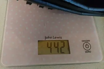

Did someone say lightweight tyres?

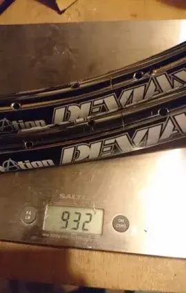

Spank Subrosa rim 520g, Alienation Deviant rim ~460g.
Thats a ~60g saving per wheel.
Bargain.
Trouble is, 36 holes means back to the drawing board for hubs.
And the green was starting to grow on me too
Oh well...
