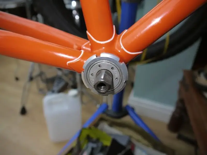

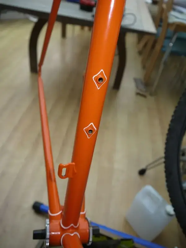

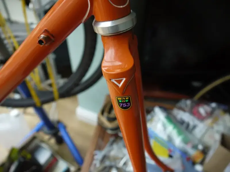

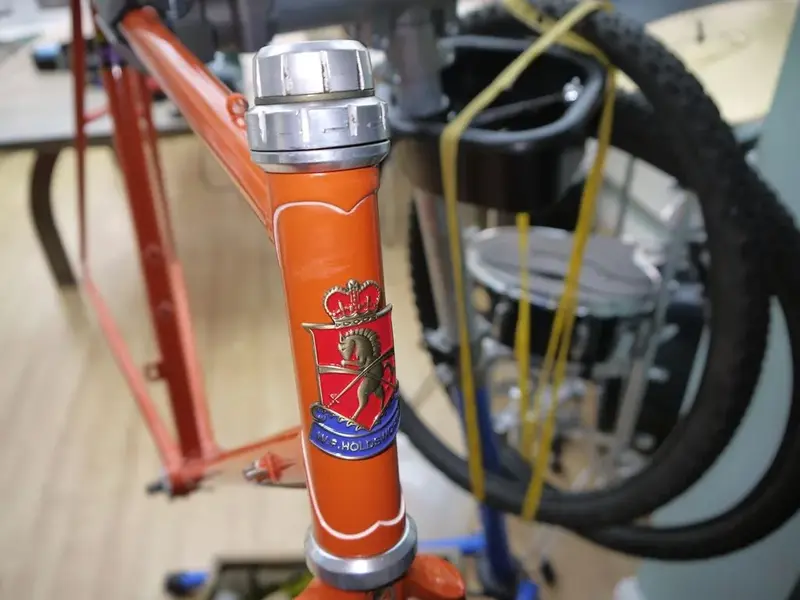

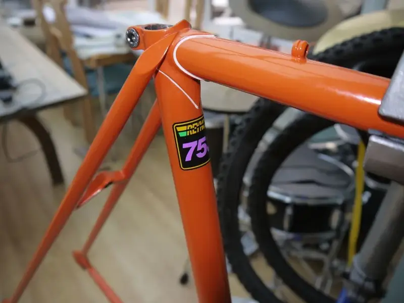

Thanks for all the suggestions. So, after much thought I've decided to move forwards on this English-built Reynolds 753 frame and forks which conveniently came with a Mavic 600RD SSC BB and Mavic 312 headset. It's original paint scheme: Holdsworth Orange with white detailing to pick out the lugs and bottle bosses. Was considering going down a Chorus/C Record route, but didn't want to swap out the BB and headset as they function so well (Mavic bearings must be some of the best!). The BB is English 68mm shell and the spindle is 116mm, so the Mavic cranks I'll fit will have the correct chainline, whereas fitting Chorus cranks would really have required a swap to a 111mm spindle.
