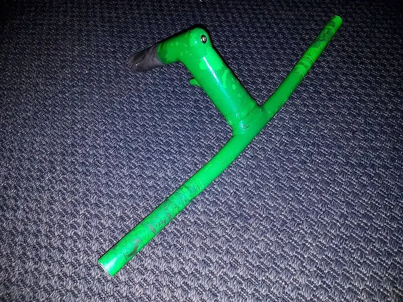

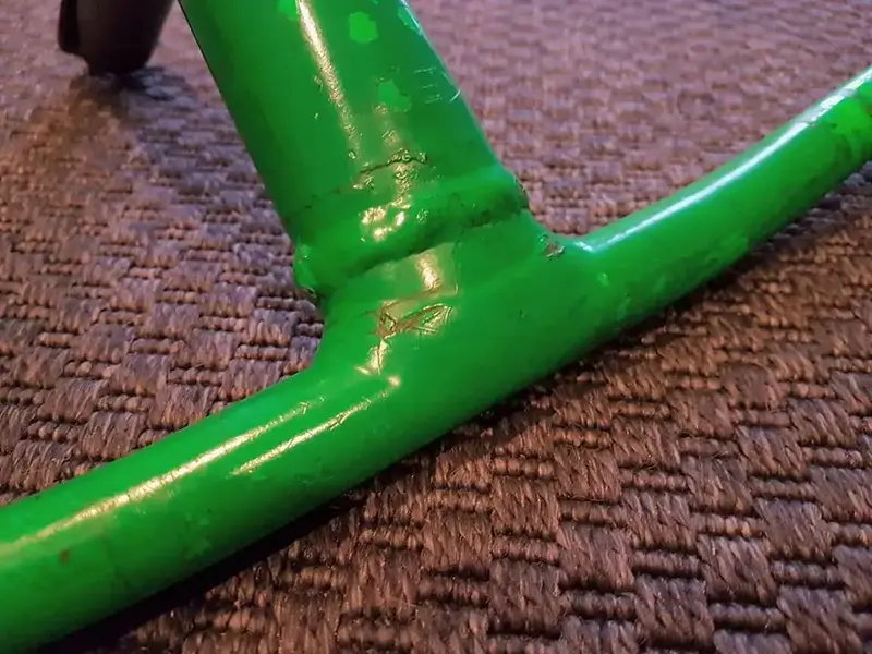

I have the original MC1 stem x 2. The original is broken and welded really badly. Another one is in very good condition
but it is not green. It is brushed aluminum color. The original Klein green color is very hard to get and to make it look original it would cost appr 150$ to paint it properly.
Another reason I would like to use a modern stem tube, stem and handlebar is that the original MC1 handlebars are extremely narrow.
Here's the original green (broken) version.

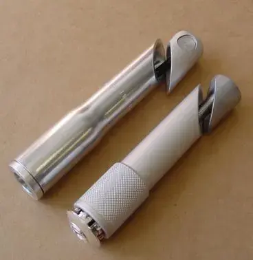

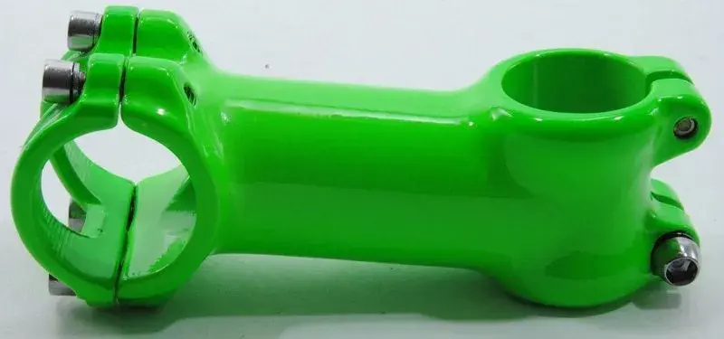

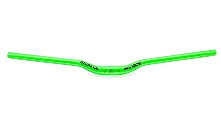

I was thinking to use these.
So, in other words I would need a threadless stem adapter, similar to this. The tube radius would need to be 31,8 mm
(similar to Klein MC1 tube).
