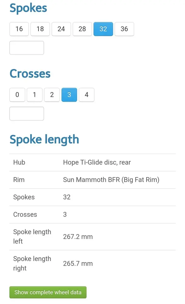

Ive looked at a couple of online calculators and they saying 265/265.8 length spokes both sides front AND rear. Its been a minute since I worked in a bike shop (circa 1996!) but drive side rears were always shorter but this was well before disc hubs were commonplace.

Hope TiGlide Disc hubs F and R with Sun Mammoths 32H if anyone can help out!
Standard spacing etc, none of this boost or thru axle nonsense!

@dbwheels the ERD looks correct on my rims to the website, would 266mm spokes work for me then or would you advise getting 266 AND 267mm spokes?
I would be comfortable going with 266mm spokes throughout. Are you using brass nipples?
If you are using the 15g spokes that you mentioned in another post, they will tend to wind up as they are tensioned. Make sure to lubricate the spoke threads before building and destress the wheel as you go to minimize the effects of wind up.
I hadnt got that far yet to be honest. Would you recommend brass over anodised alu ones?
If using brass nipples, the spoke length can be slightly out.
If spokes are too short in an alloy nipple, the head may fracture at the shoulder.
