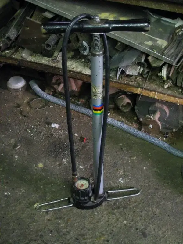

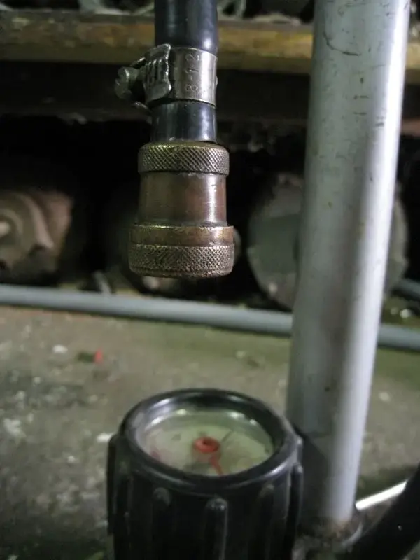

Mine in over 25 years old and looks the same as Gazelleer's, with the same push on adapter. The rubber washer wore out years ago, must be 15, and I haven't used the pump since then. I bought a spare from a bike shp but it didn't fit. I always have a Zefal HPX on my bike so I use that.
The gauge is perfectly fine, there's a red needle which you can set. In any case I only used the needle as an approximate guide, mainly as not to over inflate. The final pressure check is done by squeezing the tyre.

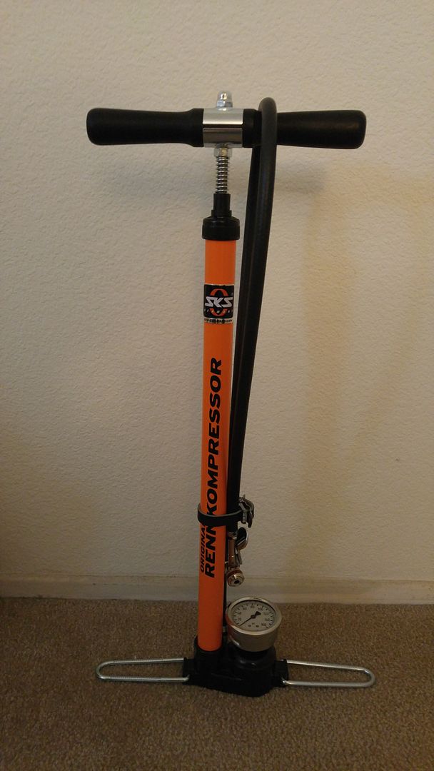

I found this thread very useful when I was considering modifying my SKS Rennkompressor pump.

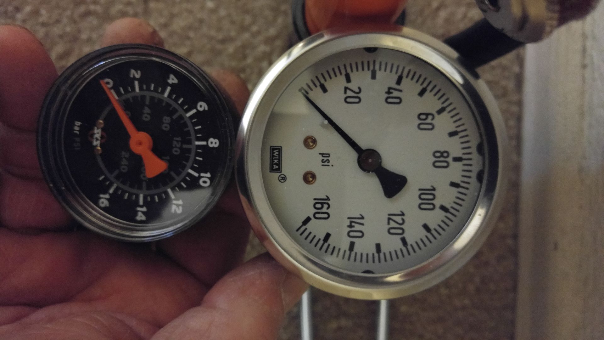

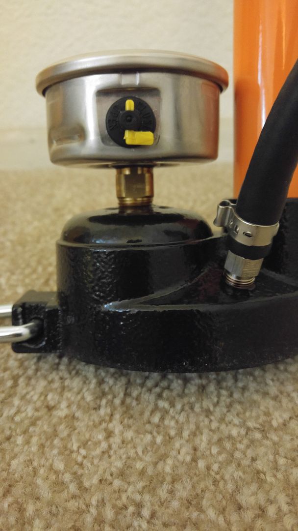

There was nothing fundamentally wrong with the pump I purchased except I found the pressure gauge to be a little hard to read. The first upgrade was therefore to replace the original SKS gauge with a 63mm gauge. The threads on the pressure gauge port at the base of the pump are 1/4 inch BSPP (G) and there are plenty of 63mm gauges available with a suitable male fitting in the centre of the back of the gauge. I bought an old gauge on eBay and made two errors: the threads on the gauge I purchased are NPT and the male fitting is offset rather than centered. Instead of buying a different gauge (which in hindsight would have been cheaper), my solution was to attach the gague using Cejn 320 series quick release fittings. An advantage of this is that in future I can quickly swap out the current gauge for one with a different pressure range (bearing in mind that I understand the accuracy of most pressure gauges is best in the middle third of the gauge).
Not content with changing the pressure gague, I also changed the hose and pump head. The male threaded fitting at the end of the hose that came with my pump is M8 x 0.75. I could not find a suitable replacement hose tail fitting with those specifications, so I decided to change to a more readily avilable 1/8 inch BSPT fitting. This meant having to drill the hole in the base of the pump to make it larger and then use a tap to create 1/8 inch BSPP threads. I had never done this before, but I consulted some drill / tap charts, watched a few YouTube tutorials, bought a suitable drill bit, tap and tap wrench and then gave it a go. It was quicker and easier than I expected and I managed not to mess it up.

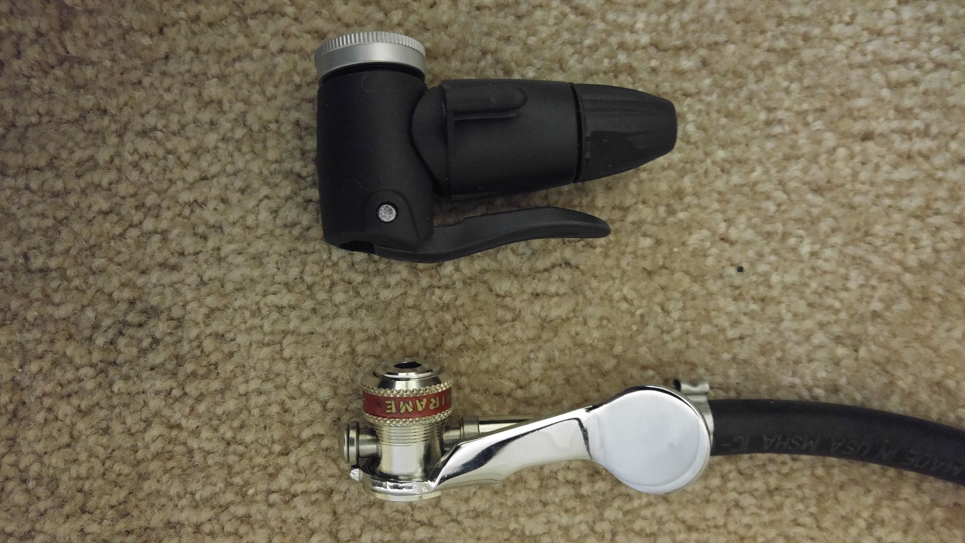

For the hose, I used 1/4 inch Flexzilla in a lairy chartreuse colour. For the couplings and adaptors, I used items from the PCL XF Euro range (compatible with Cejn 320 series and many others). The hose and fittings are attached using Oetiker 167 stepless ear clamps or traditional worm drive / Jubilee clamps. Finally, the pièce de résistance at the end of the hose is a fabulous Hirame / Kuwahara pump head which is a real pleasure to use on presta valves.
All in all, the cost of making these changes was considerably more than the cost of the pump itself, but I am very pleased with the outcome and along the way I learned a lot about pipe thread standards, air compressor systems and pneumatic couplings and adpators. As a bonus, I also learned how to drill and tap a hole in metal.
