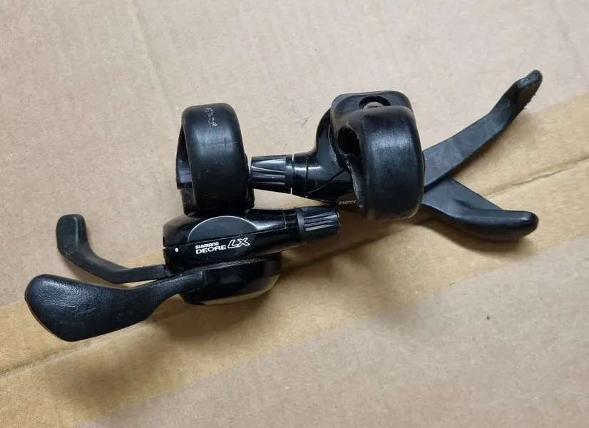

Here Shogun with Trigger from LX65x series

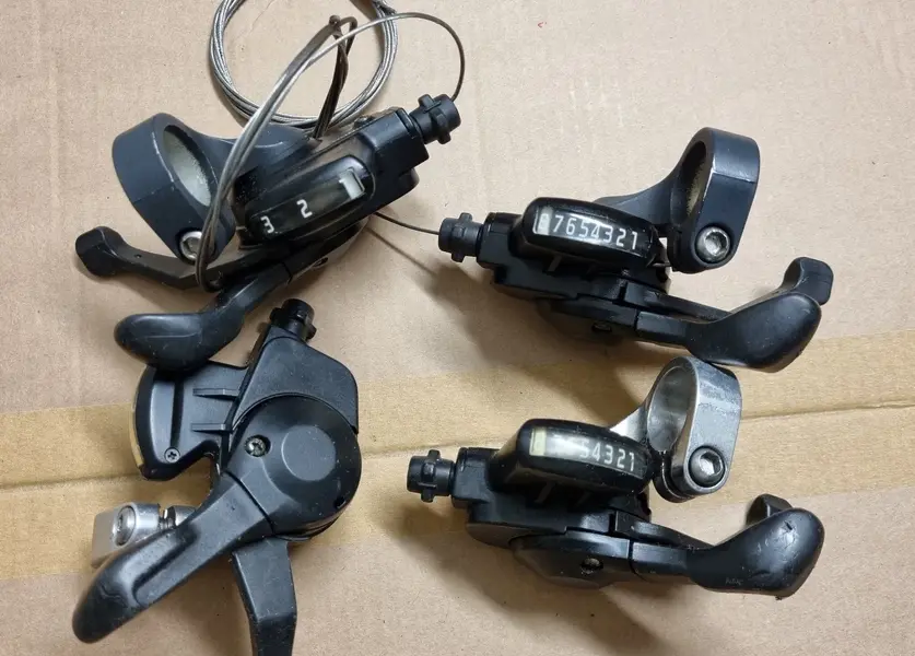

The lower one in the pic is the right hand 008 shifter
The upper one from this picture is much easier to find and cheaper, my clear recommendation, STX (RC) SL-MC38, 40, etc. shifters.
They are available with polished, silver or black aluminum clamp, with or without gear display and with 7 or 8 speed.

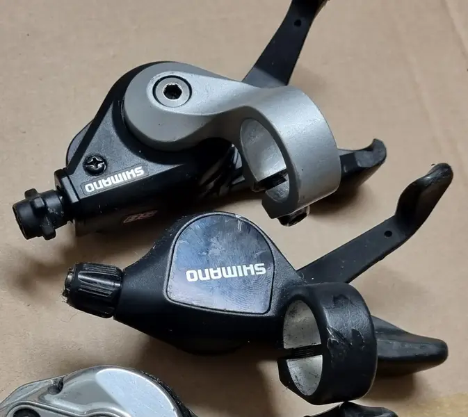

Some more
Even if one doesn't like the shifter itself, those are a good source for a nice aluminum clamp.
With a very small hack (4 small holes) those clamps fit also to the trigger of earlier XT73x or XTRM900 STIs.

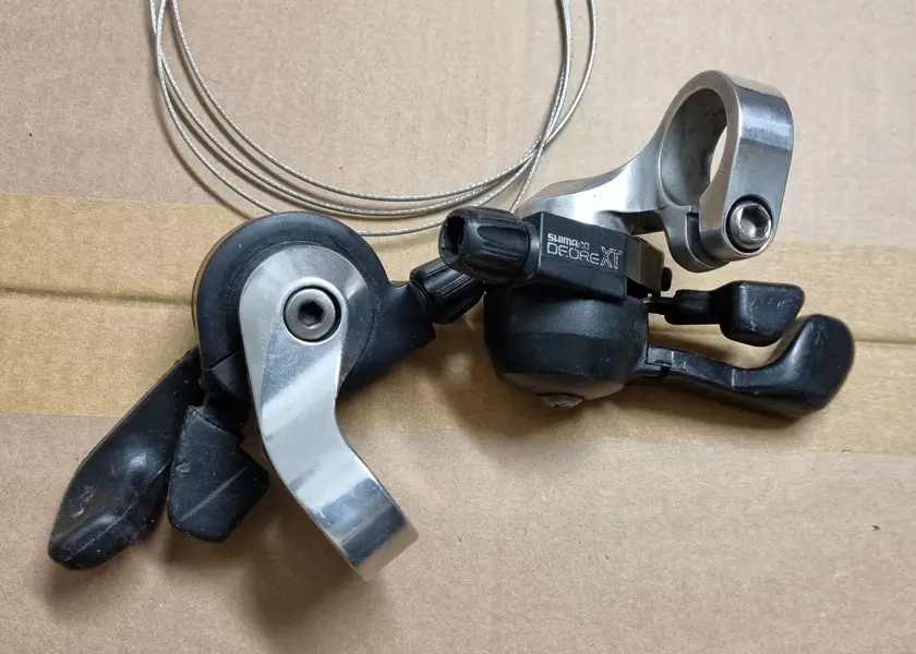

Here some
