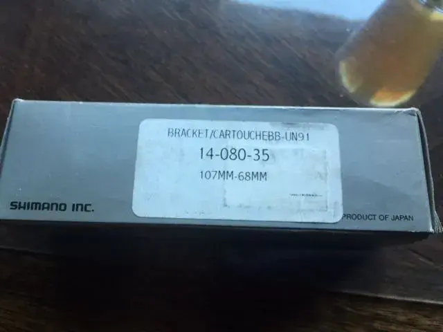

For my 1994 Stumpjumper FS, the green bike pictured in this thread, I'm assembling a parts list to convert it to M900 XTR, leaving the cranks, headset, and brakes alone since I have upgraded parts there already that I'm keeping. Here's what I have so far, looking for input on the bottom bracket (I've read the Sheldonbrown website but it's difficult to get to the answer I'm looking for).
I'm looking for a long cage rear derailer, M900, that seems simple enough, but not sure which cassette to get. Are all 8 speed XTR cassettes created equal to fit my Ringle rear hub? I purchased a new old stock set of M910 shifter/brake levers (I like the gear windows) so I have those read. And as I said I know the front derailler I need. My last question is on the bottom bracket.
I purchased a brand new XTR UN91 "107mm-68mm" on ebay and probably should have researched first before I bought it. I am hoping that a) it's compatible with my 1994 steel framed stumpjumper for width and b) that the spindle size is what I need, given that my bike has Raceface cranks circa 1996 or so when I added them. The chainstay length seems to match the original Shimano LX (107-113) that my bike came with. What's the best way to decipher this compatibility equation on this XTR bottom bracket? Are there numbers on the cranks I should be looking for that will give me specs to solve for the compatibility?
