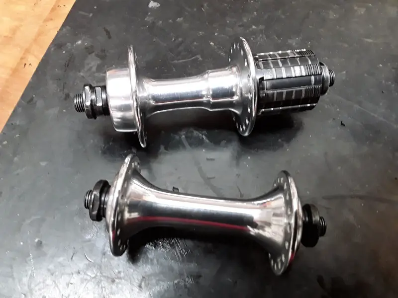

Like this on some m730 hubs i wanted to modernise away from uniglide.....which can be a sod to get off and harder to find sprockets now.
