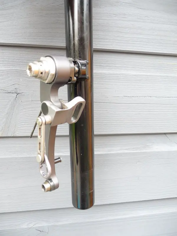

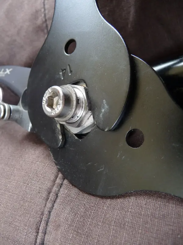

Found some of my old photos, now I'm guesstimating from over ten years ago.
That doesn't need to be attached when doing that bit..
Pop it back on after.
And I'm guessing this is trying to tell I either popped it on a fork leg for a) to help keep it still b) check it worked c) to align the parallel arm correctly d) for a photo opportunity
I think the mistake I made was to try and shortcut the process (over confidence having done many previously) and assembling before adjusting the bearings, hence why the come spanner pushed against and snapped the linkage mount. Seeing your pics had me realise that, thanks.
