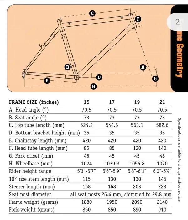

My 1997 P7 had a 29.8 shim in it, see the below from the 1997 catalogue...
