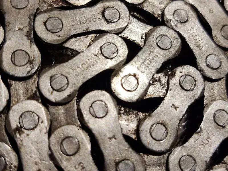

While rummaging through my chain box looking for an 11sp quick link I discovered a Sachs chain wrapped up in a bag. I forgot I had it, must have been when I was doing a suntour xc pro build. I'm trying to work out what model it is, as I had both 7 and 8sp xx pro at the time.
Can anyone help from the pic?
As I don't need it, I'll be making it available but want to know what it is.

It looks like a sacks sedis chain to me bur as I haven't seen 1 for years I could be miles away from the truth

just the chain rivets design may have changed, looking at the PC 91, this looks different than the SC M 90, if those had been both top of line chains, just in different years.
