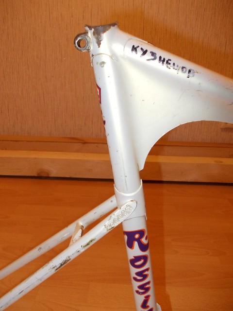

I haven't thought of sandblasting, I think I want to work the steel by hand. Sandblasting is too easy haha.
Thanks ColnagoC59 for the decal reccomendation, i may give him a ring.
Today I learned, with the help of my Russian friend, that the frame belonged to - Кузнецов - which can be seen on the frame, written in permanent marker. The name in Russian is that of Alexander Kuznetsov from Leningrad, Russia. The seller has also confirmed that this is him.
Kuznetsov has been a coach since 1964. In the USSR national team since 1985. Coach of the USSR on the track at the Olympics in 1980 and 1988, head coach of the United team at the Olympics in 1992, the coach of Russian national team at the Olympics in 1996, 2000, 2004. He has coached many world and Olympic champions in track cycling including Vyacheslav Ekimov.

A word of warning...
Do not be tempted to put new filler on top of old filler, the old filler will draw the moisture out of the new filler too quick and cracks will appear at some point in the future. If you are applying new filler then remove all the old dried filler first to prevent this happening. Might be worth having a word with a local car body repair shop to find the best way forward
MAtt,
The story gets better - history with the frame!! Take plenty of pics - you might be able to get the name on a decal.
Re the paint etc really you should speak to a framebuilder or restorer - eg Mercian to see what the best way forward is. Be warned that when you strip the paint the frame will be really prone to surface rust. I was warned about this when i had mine sandblasted. The sandblaster put his coat over the frames to get them to the car and said to keep them beside a radiator until the undercoat was applied. I was also told to keep them in a plastic bag to stop air getting at them.

I can assure you I'm not planning on getting it wrong. I have a long list of professionals who will be helping me along the way. I'm am just examining and preparing the steel at the moment.
Today i have been in touch with an engineer who is looking at creating the handlebar clamps. A lot of frame builders have said they can't make those bits.
