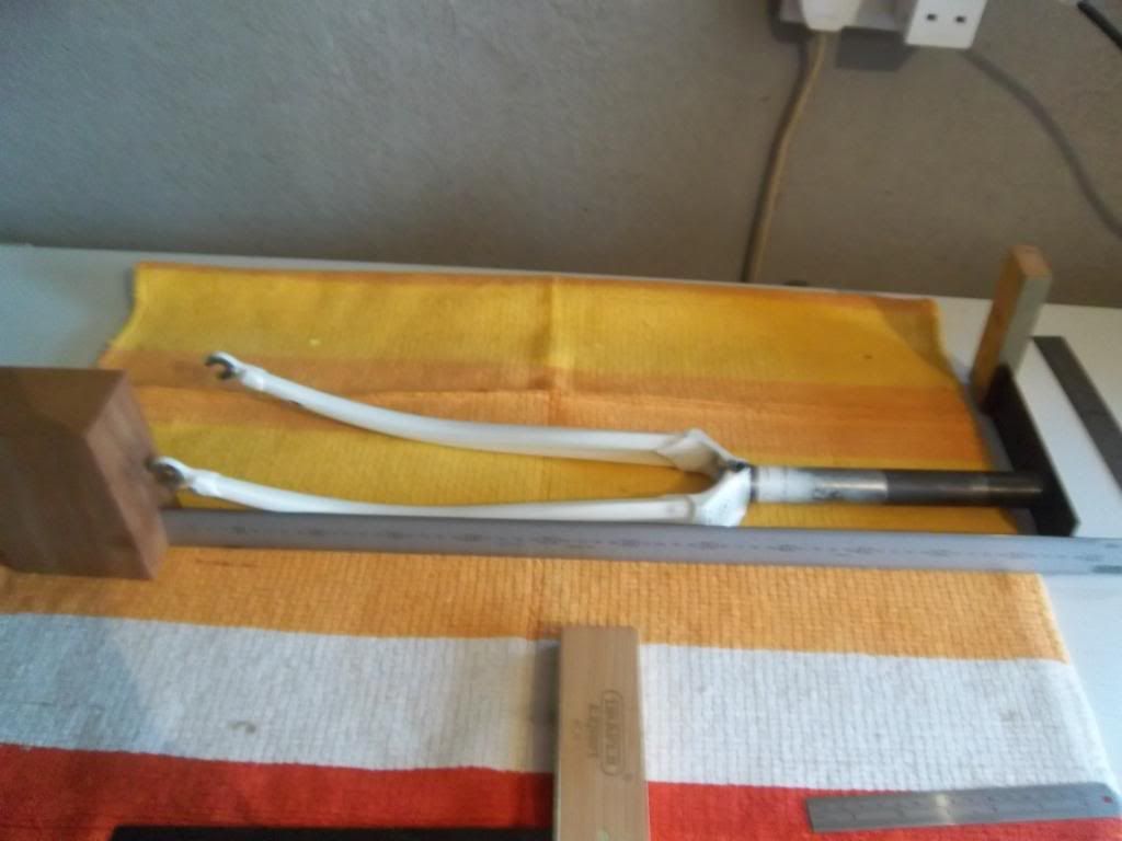

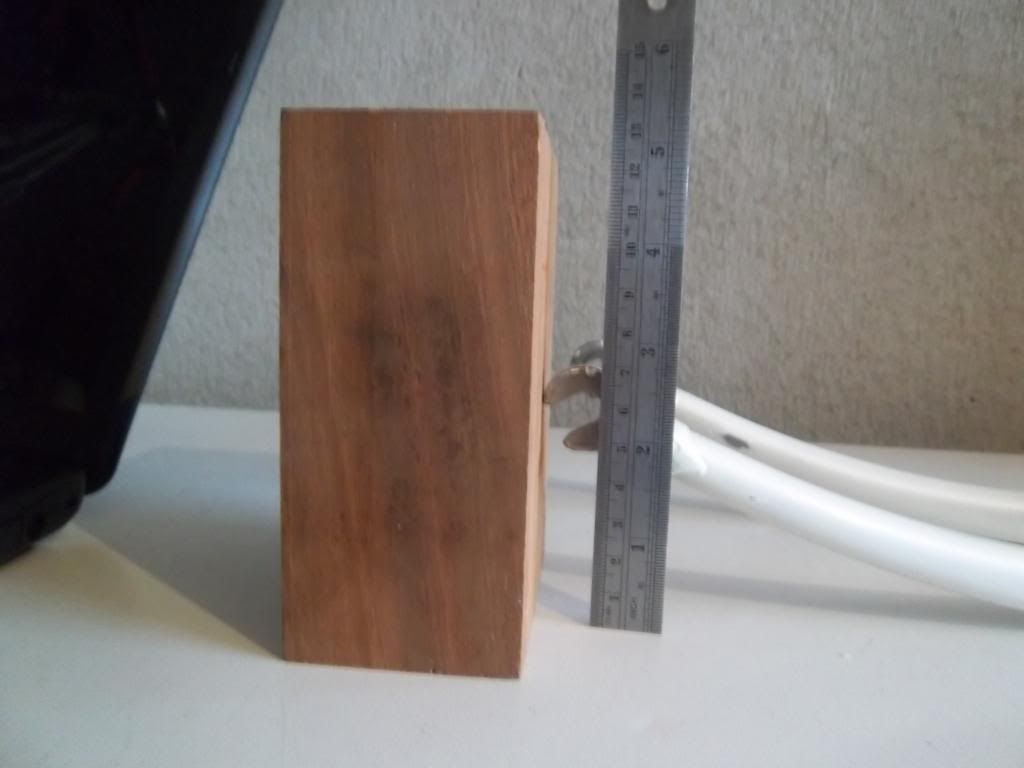

I will be able to measure axle to crown, but I have no idea how to measure the rake - any ideas welcome.
Richard
rest back of fork legs on flat surface in a way so steerer is parallel to that surface.
measure distance from surface to center of drop out.
subtract distance from surface to center of steerer tube.
presto.
Great stuff!!
Thanks, I should have it done by lunchtime, if things go to plan.
Richard
I am early!!! Unusual for me!

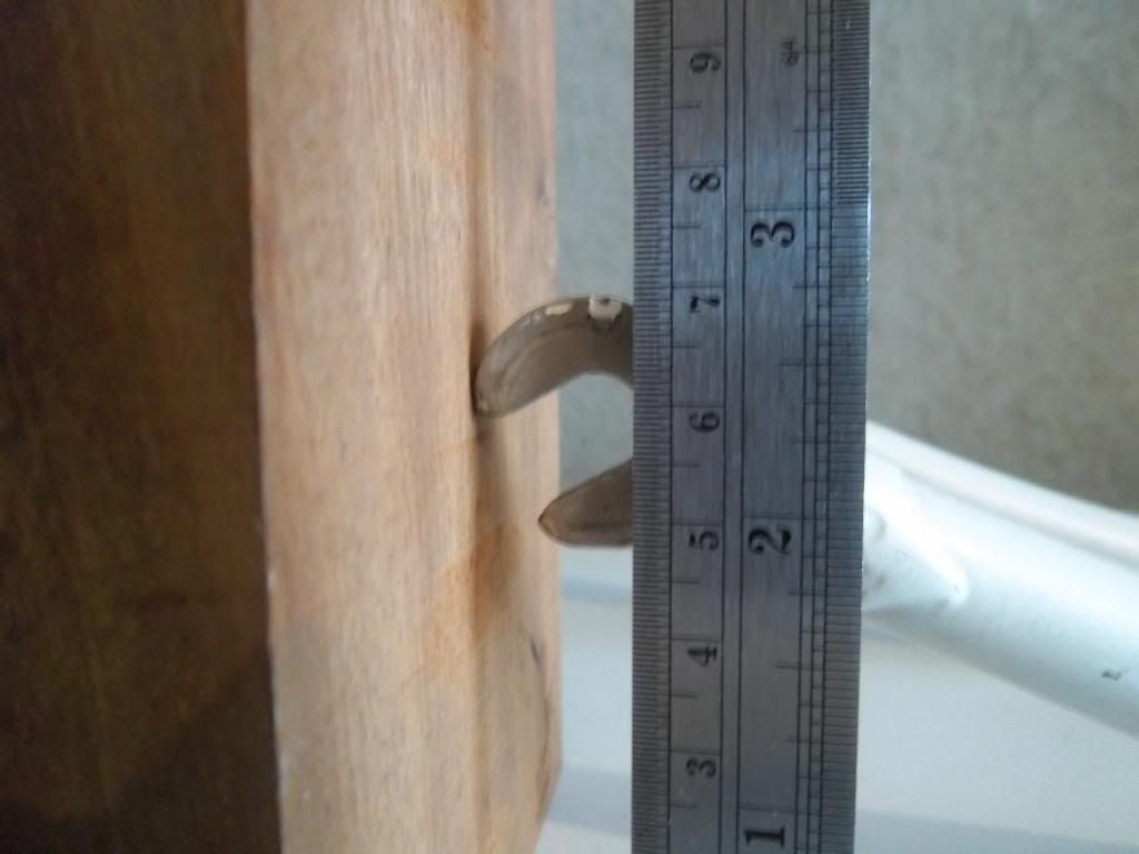

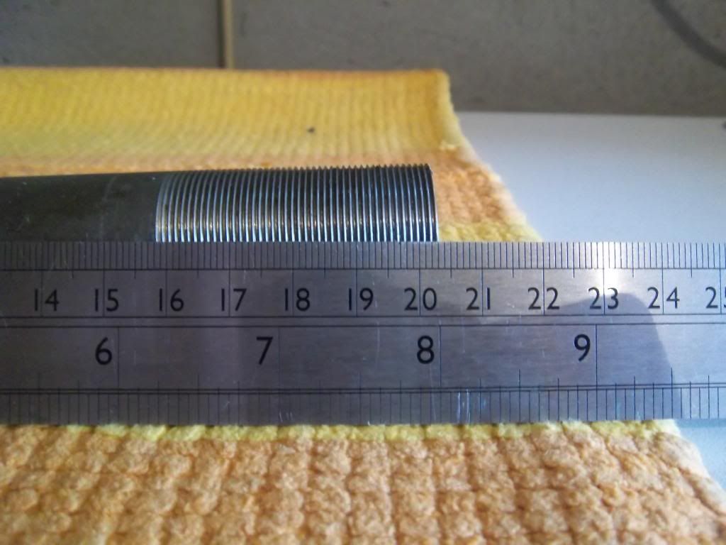

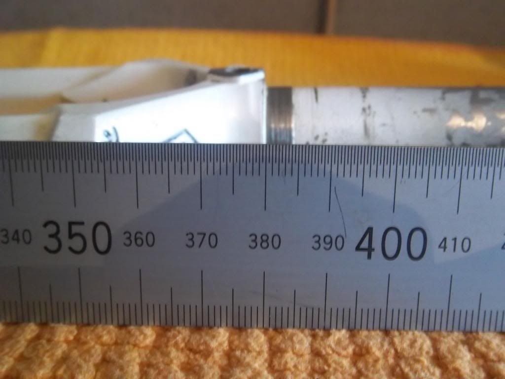

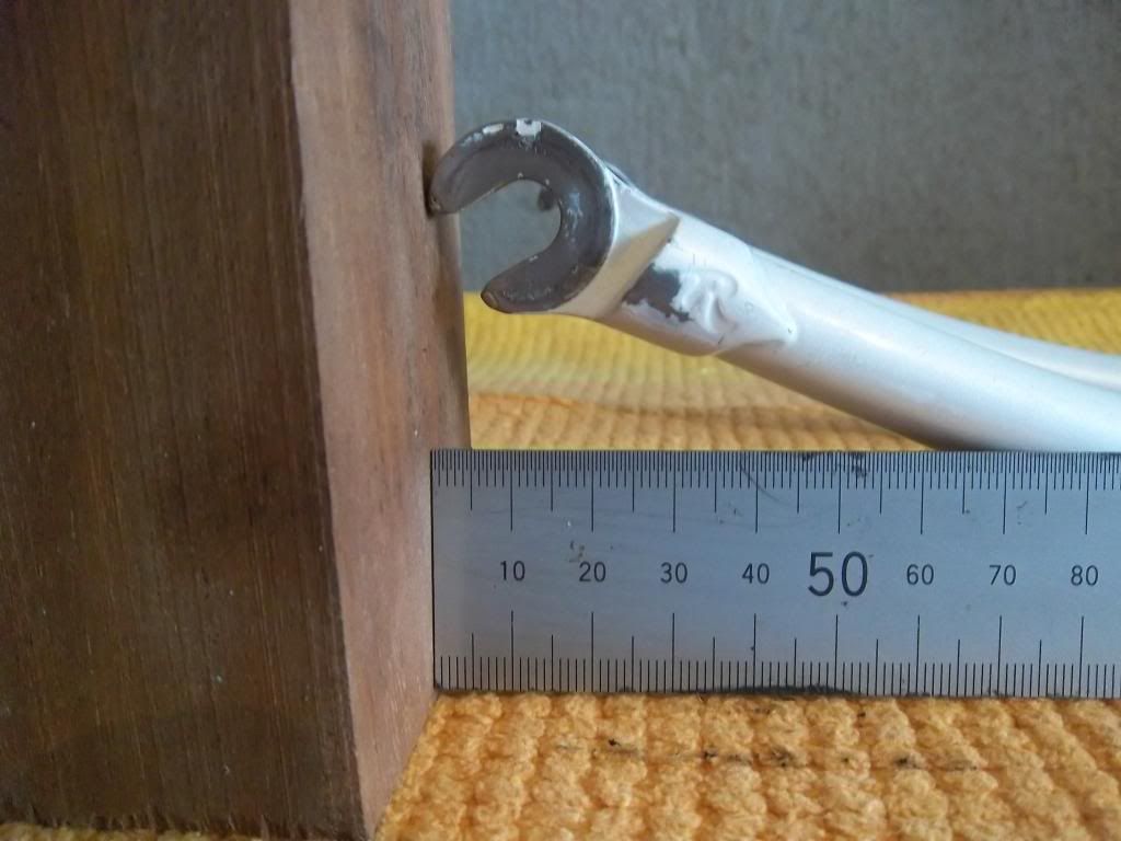

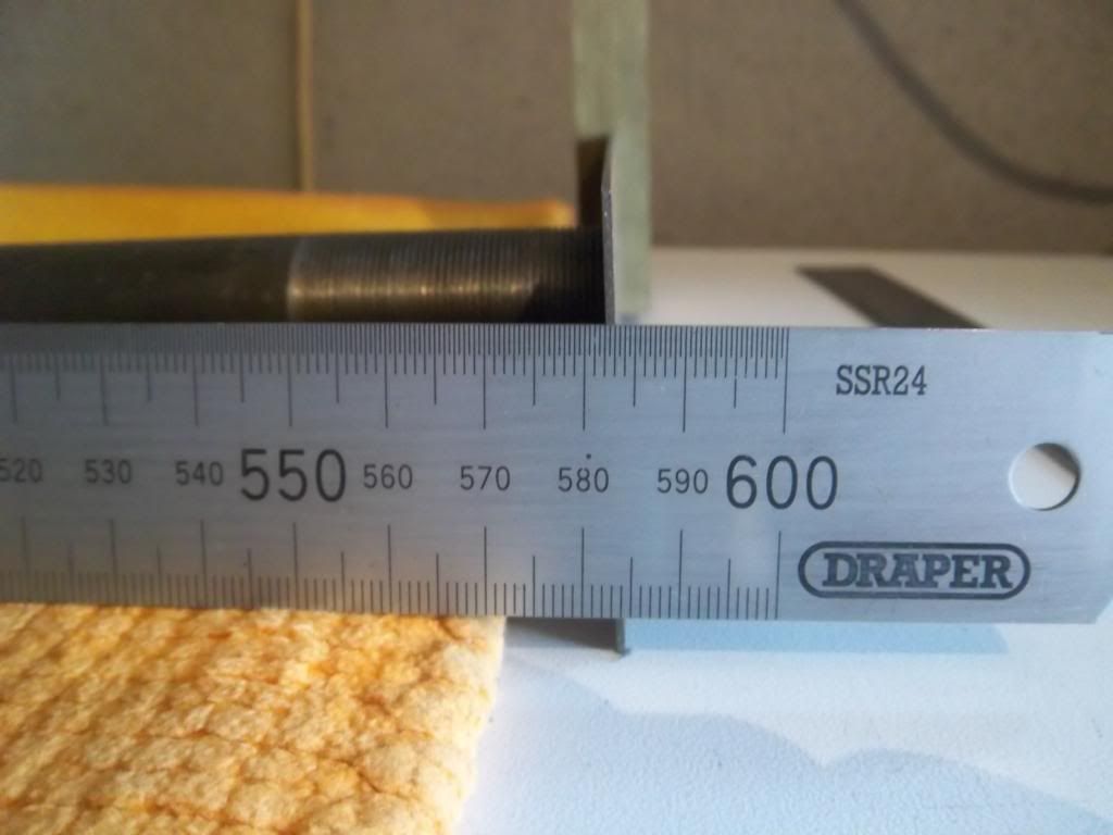

here are MY measurements - apologies for any errors but i was careful -
Steerer length - 203mm
Total length - 583mm
Fork leg length - 380mm
Measurement from base to centre of dropout - 58mm approx
Pics may help if i have got something wrong -
I hope this is enough for you, if not, it will be a few days before I can get peace to take any more measurements.
Richard

you forgot to subtract base - steerer centre distance from your last measurement.
if you do this you'll have the offset/rake of the fork.
