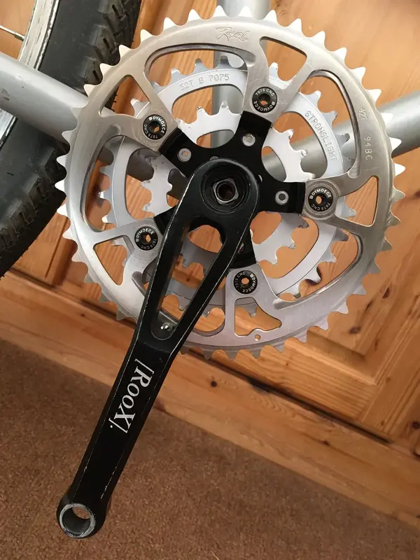

[RooX]. crankset - what length BB?
Captain Stupido
I thought I had the right BB for this... but no. Somehow the one I had stashed is for a 73mm shell (I needed 68mm), and a fair bit too long wih a 122mm axle.
Anyone know the recommended BB length for these cranks?
I certainly ran some with a 115 mm EDCO bottom bracket, now I think about it, but that was with a single ring, so I can't be sure it's the correct chainline for a triple.
Beautiful cranks! I wish I had kept mine.
