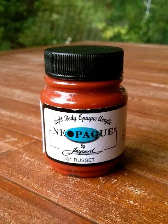

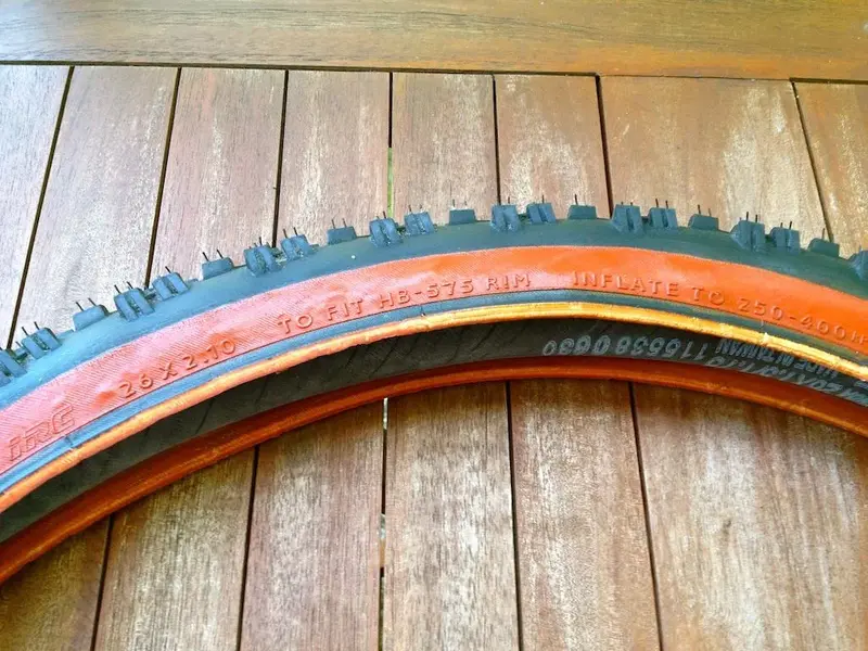

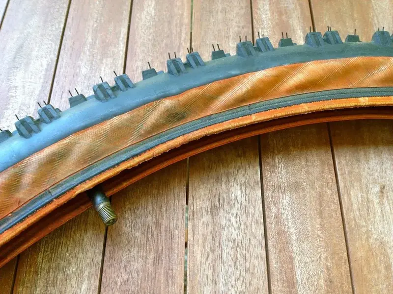

I finally got around to experimenting with a few inks from an artist materials store. They were about $11 each. I bought three and did a test patch for each on an old knackered tyre. When dry, I chose the one I liked the look of and treated the other two tyres. I mixed the ink (pictured) 50/50 with water, applied it with a half inch wide brush, and then went over it with a damp sponge to kind of 'bleed' it in.
I'm sure with further experimentation I could match the colour exactly, but it's close enough for me - and it'll look better when it's worn in a little.
