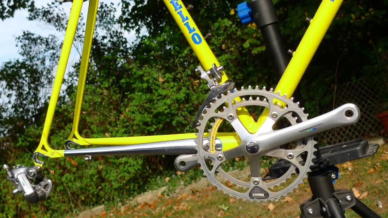

Shimano cranks are 'JIS' fitting and not compatible with square tapered BB axles
What do you mean? The bike actually came with square BB and Shimano cranks:

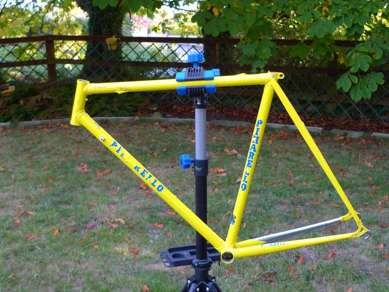

Some update on the project...

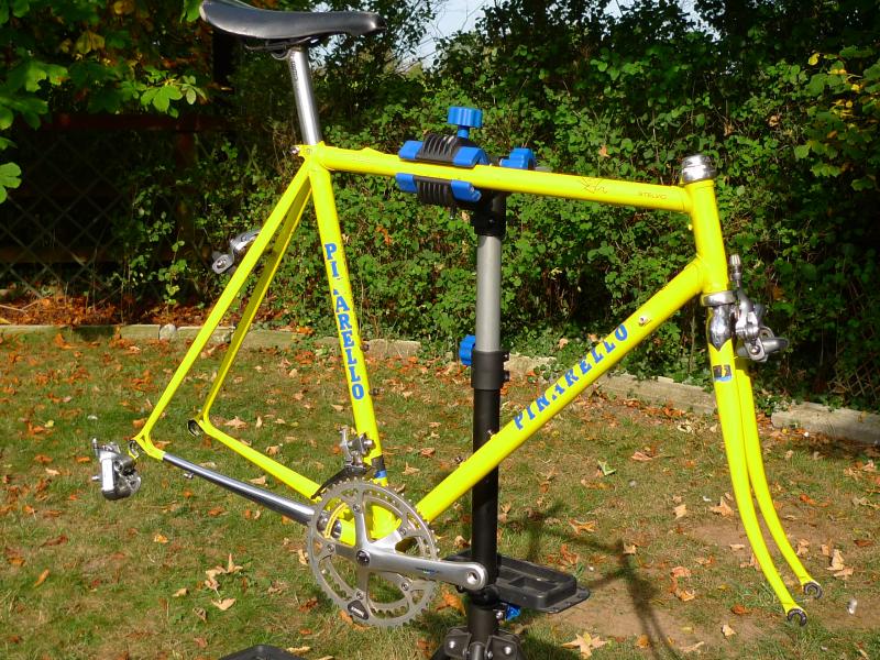

Got the frame and parts cleaned, put in a new bottom bracket, a newly sourced chainset and started re-assembling the bike.
The rear wheel axle was broken in half, so I give it to a guy to repair and service them and will hopefully collect them back tomorrow.
The headset bearings are very rough and I have to wait again for a new bearing set. Hopefully the headset can be re-used...

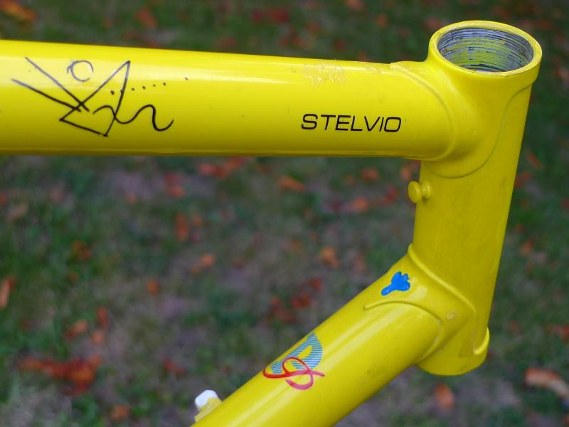

Nice frame - I like the Stelvio. I have recently acquired a similar period frame (Pinarello Asolo) for rebuild/restoration. A couple of questions for you;
1. Have you managed to obtain any period Pinarello brochures?
2. Are you planning to repaint the frame?
3. Do you have any information sources regarding Pinarello serial frame numbers?

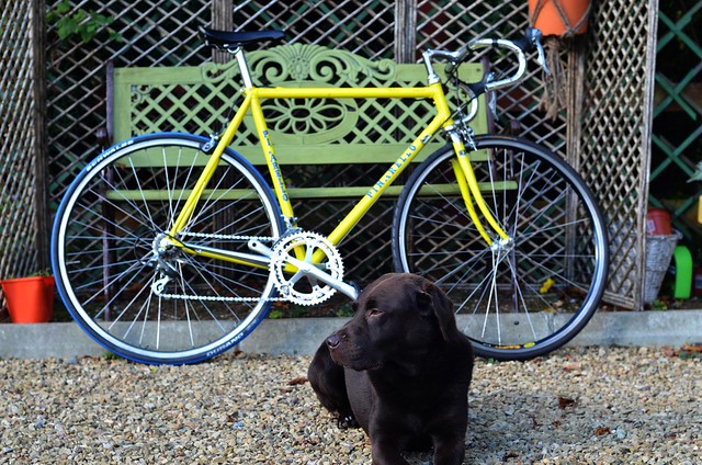

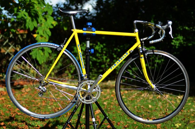

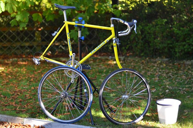

Hi Guys,

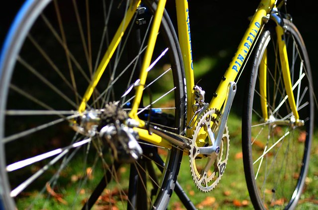

I finally managed to screw all bits onto the frame after getting the wheel axle replaced. Adjusted the brakes, gears, etc.:
Final approval by the house PR Manager before the test ride:

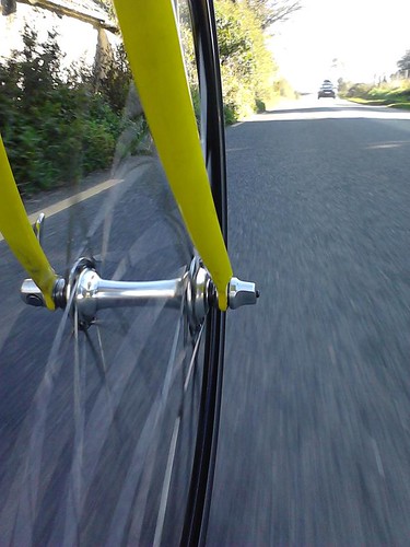

On the road:
At the next phase - the stem needs to be changed to a different size, handlebar to be wrapped with tape and a new cassette is badly needed (or possibly a complete rear wheel). It is unbelievable in how bad state some parts were (i.e. the cassette).
