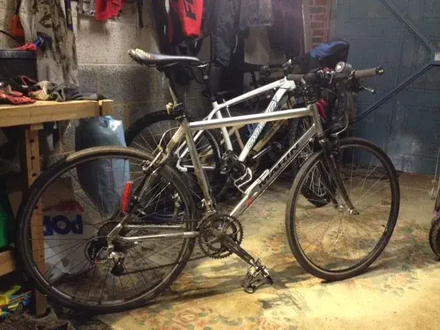

Thanks for the thoughts on the Mavics I'll steer clear of them! As for drop bars...I have tried them but I had 2 problems with them. Firstly I felt less stable/steady when in the drop position and second I suffer from lower back pain and the ride position didn't do it any favours! So I'll have to leave the racer stance out! Thats why I ended up with the Hybrid (see pic attached) although mine has had the original wheels replaced at some time with cheaper ones which are making a bit of noise in the hubs and are a bit egg shaped! Thats why I am thinking of replacing them. Currently I am running 32mm Panaracer Ribmo tyres which are bullet proof! So another question would be what width of rims would suit 32-25mm tyres?
