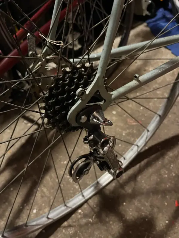

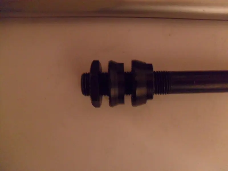

Bit dark, but from the left, inwards…
The qr lever, a serrated washer (2mm), the first lock nut (8mm, which I’ve just threaded onto the right of the dropout so I don’t loose the blimming thing), dropout, thin steel washer, inner locknut
The on the DS, the mech hanger

You're right, it's a bit dark. Looks to me that what you're calling the inner lock nut is actually the cone. Whereever the serrated washer came from you don't need it. It should be the 8mm lock nut, the thin washer and then the cone. There are different thickness Campagnolo lock nuts - you've got the #33 which is 8mm, there's another similar in design which I don't know the number of but is 6mm then there's the Nuovo Tipo 4mm thick #1283 lock nut which is a hex nut rather than a collar with cone spanner flats.
