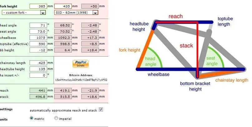

When taking angles into consideration you need to take account the length of the bike, a longer bike (wheelbase) will not be altered so much compared to a short wheelbase bike and you need to account for sag in the forks under actual use not just it's axle to crown length. A longer travel fork would usually be used with a greater sag setting.
The biggest problem designers have had (other than new EU tests or whatever they are) are stopping the long forks snapping the frame with the increased leverage of a long thing.
To negate the slacker angle you can use a shorter stem to get the 'quickness' of steering back. Kona used this principle for quite some time. Though it does alter the reach and many other things
http://bikegeo.muha.cc/ is a good simple site to use
