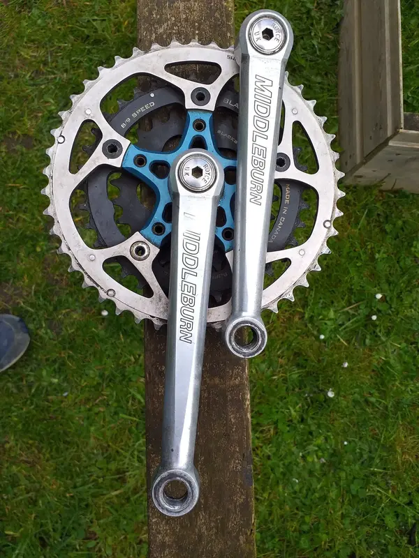

Are a nice earlyish middleburn chainset . Royce dust caps
Pic below

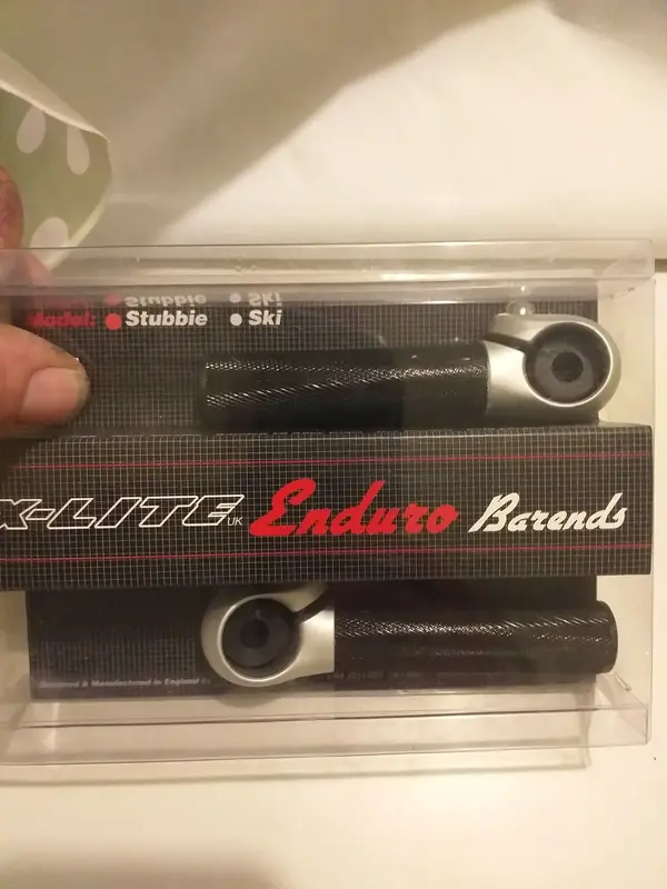

Nos xlite stubbie bar ends from lbs a few weeks ago 😁

But is the chainset and the magura to early ?
And will they look odd together?
I'm not going for a period correct build but would like it to look like the parts belong together.
Just curious to people's thoughts /opinions

Welcome to my world, I've had this with my AMP build which is also 95 model year. I've gone for Xt 737 & a raceface chainset
Your chainset is 1991 but loads of build had carry overs so if it works for you fit it & enjoy. If you don't use it let me know as I'd be interested in it for my next build I could maybe trade you some bits.

1991 is square seat tube territory but I love the look of the arms and would like to put a British chainset on .even if it's not this one .

I've found a more appropriate frame for the middleburn chainset .😉 20210609_153924.jpg

I’ve pretty much got the exact frame as you. It would have had a Royce Ti BB and a good chance an original Pace A-head stem when new. The Royce BB’s aren’t cheap
definitely suit the Middleburns and wheel wise 231 cd’s were pretty much the rim of choice. Original Pace hubs are an option but getting rarer. Brakes more than likely would have been hydraulic rim brakes either Hydrostop’s or early Racelines
