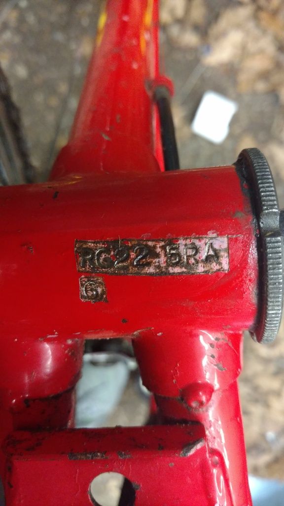

Hi, I've just picked up an old Raleigh racer I think from the early 80's.
The very rough paint is in the team colours of red with black head tube but it has no decals to identify it by, when I got home I took a picture of the serial number on the bottom of the bottom bracket
I think at most it'll be a EUROPA or an ACE..... of what i've found out R is Canada, G is May and 2 is 1982. it would be nice to find out what model it exactly is but if i can't i'll do a team replica...

mmmmm now looking at it.... seems very neat could well be a 90's police stamp...
will have to look over the bike for any other numbers... cheers
The plate for a kickstand wasn't a consistent Raleigh feature ontheir road frames. The number might be hidden under the seat tube beneath the seat bolt. Any other pictures of the frame itself?
Shaun
Will get more photos tomorrow, just had a quick look out in the garage for numbers by the top of the seat tube and I saw NK20-23737.
So Nottingham July 1982 I think....
is there anyway of finding out what the 23737 means ?
The last digits of the raleigh standard numbering system were simply the unique serial numbers..........kept the bean counters happy :)

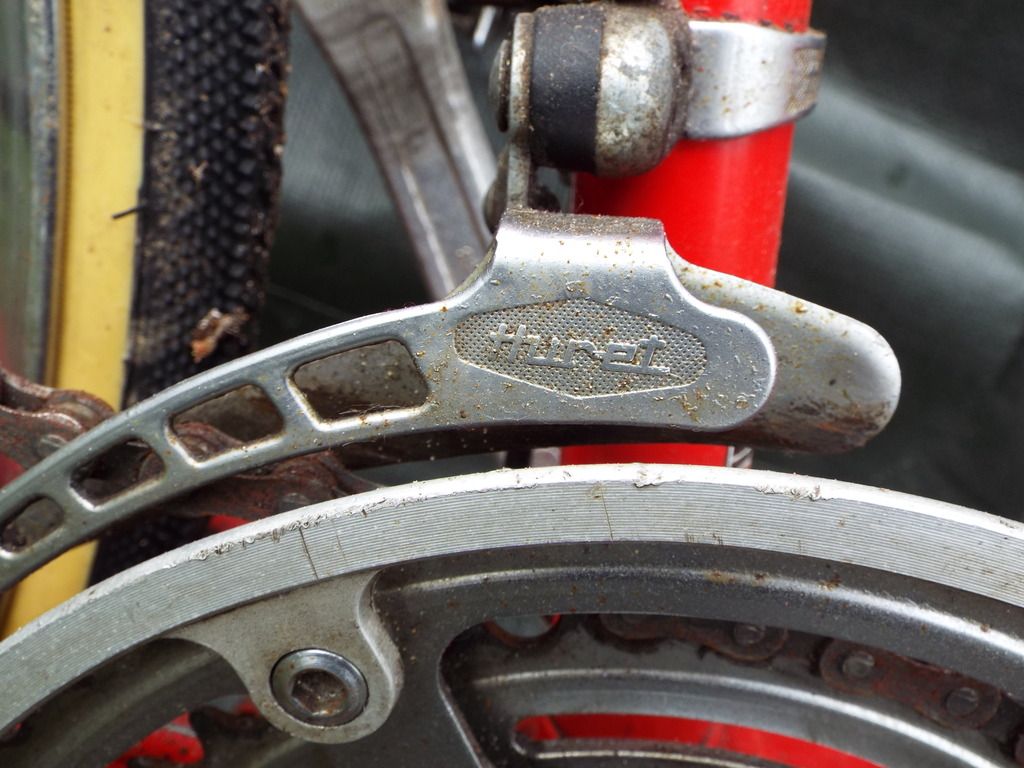

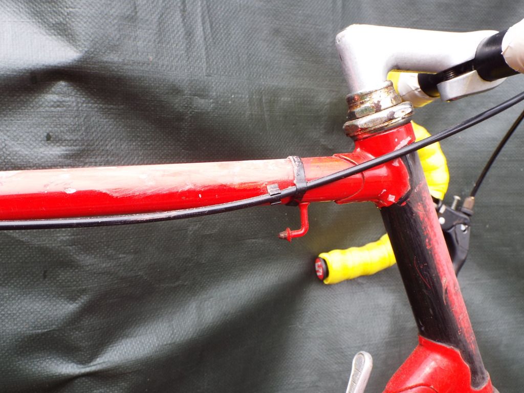

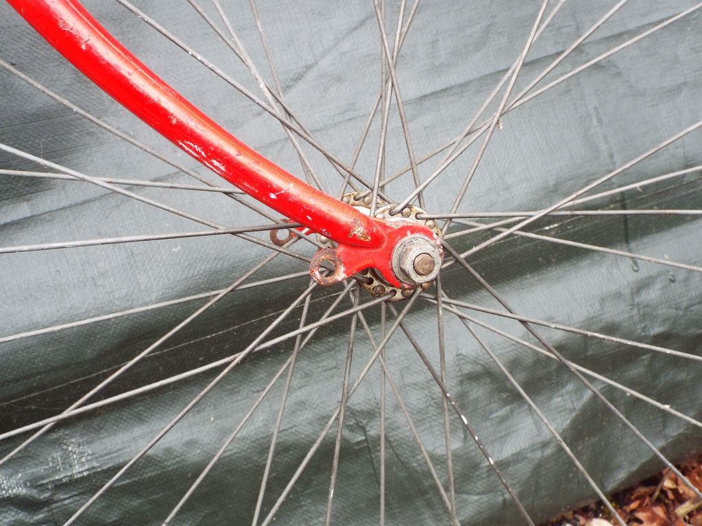

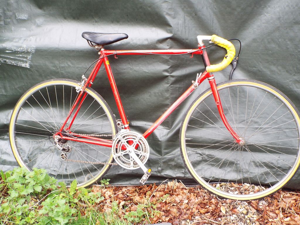

Just taken a few pictures....
it's a 12 speed, I think a touring judging by the forks. But I haven't seen one with those black plastic cable clips on the top tube.
