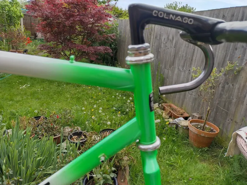

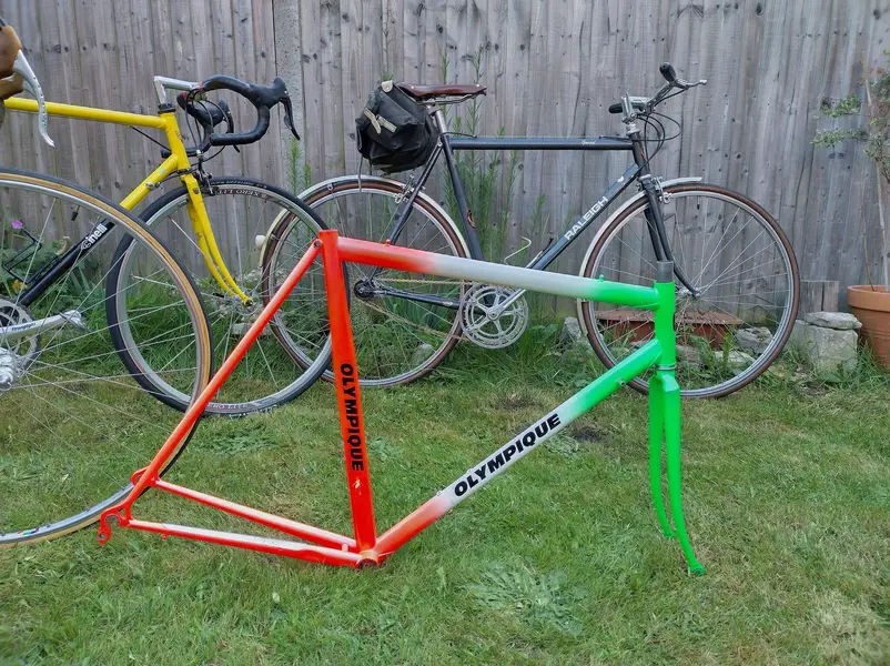

The Raleigh Specialist Bicycle Development Unit at Ilkeston and later Nottingham built over 10,000 frames from 1974 onwards but so far only 6 Dynaflite's are known to exist that is until now... Dynaflite No7 has turned up. It's has been built up with mostly high quality NOS components but never ridden since it was built before 2010... Screenshot_20220427-055545~2.png IMG_20220510_150624_HDR.jpg IMG_20220510_150640_HDR.jpg IMG_20220510_150643_HDR.jpg IMG_20220510_150634_HDR.jpg IMG_20220510_150649_HDR.jpg IMG_20220510_150643_HDR~2.jpg
The three prototype frames built didn't have any support gussets at the head tube and bottom bracket unlike the production SB numbered frames which all share this feature. Now with the bike striped down I can decide what components are going to be suitable for the build...

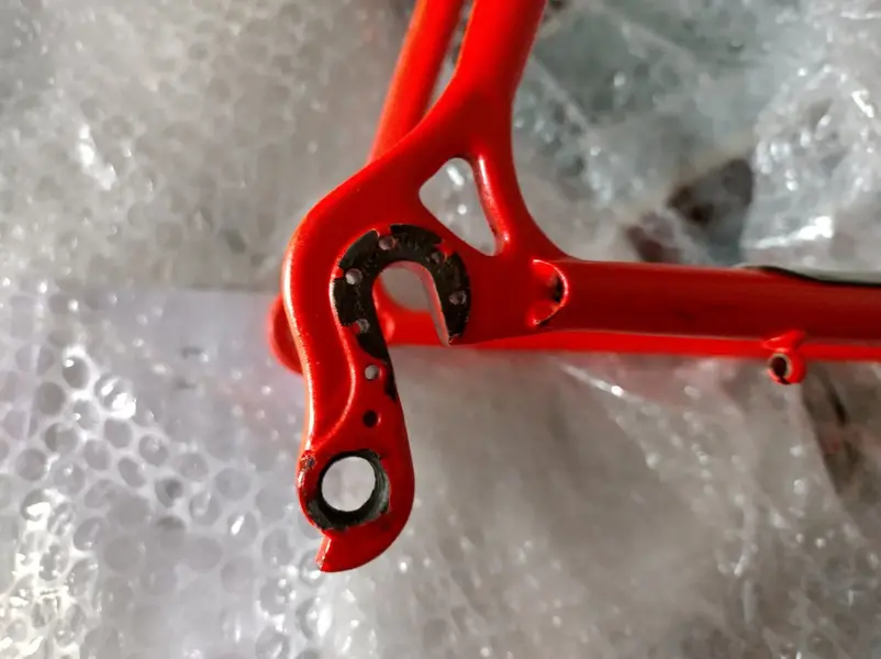

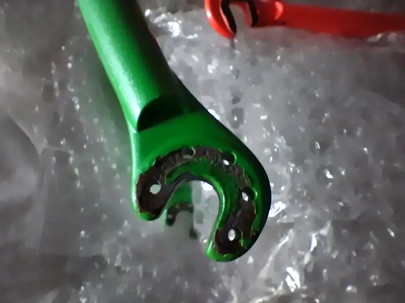

Drilled dropouts are a feature on Raleigh 753 frames though it was not always the case. The Team frames, prototype or special customer builds didn't have this feature along with the later 753 frames. Bit of an odd combination on my frame with Campagnolo dropouts upfront and Shimano on the rear 😱...oh no not Shimpag..🤣

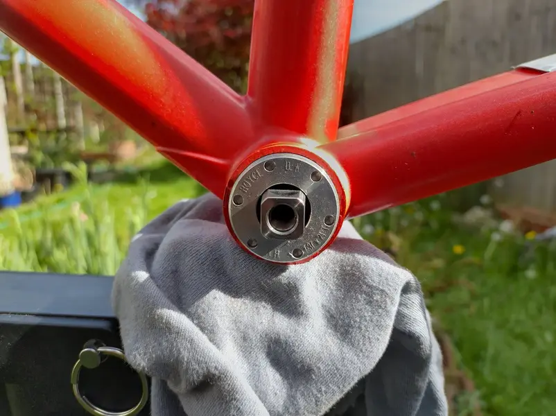

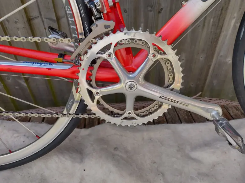

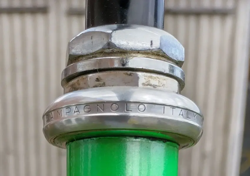

The only parts that are going to make through to the build are the beautiful Campagnolo Victory brakes and the Campagnolo Super Record headset. Luckily l've got a spare Super Record alloy top nut and spacer to replace the steel ones fitted. Not sure if the Royce Titanium bottom bracket is going to work with the very special chainset I've chosen..🤔

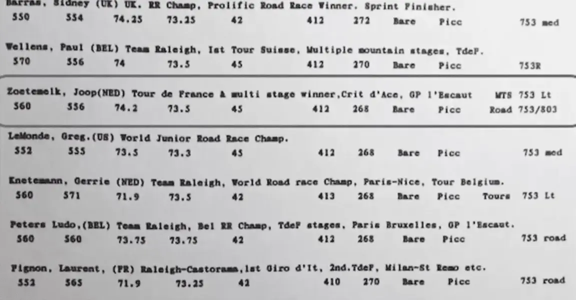

Weren't all Raleighs sized by BB centre to top of seat tube? My experience of them tells me so.🤔
Measurements that can be transferred frame builder to builder are centre of tube as a technical drawing shows. On a normal tube frame add or detract 15mm.. with oval it becomes 25mm.
This is a Team Raleigh chart, seat tube sizes are C-C.
