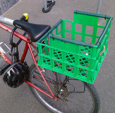

I use it with a set of cheap panniers, but you can make things out of plastic containers if you don't mind funny looks: https://www.crazyguyonabike.com/doc/?o= ... =1841&v=2O
Or possibly use a plastic crate as a basket.
KDM.. All great tips thanks, but maybe trailers and new bikes is a step too far. Xerxes.. Those 'bike buckets' are awesome and the guy is a bit of a commedian, great article!
Repacking two or three bags of supermarket shopping into backpacks and compartmentized luggage systems is too much hassle when one just wants to get going and ride a mile or two home. The 'crate on a rack' solution looks like a winner, just drop in and go!
Maybe the bike handling would feel 'top-heavy' and unstable with 'crate on a rack'? Perhaps a pannier system would be better with it's lower CofG.. Just need to try them out and see i suppose.
