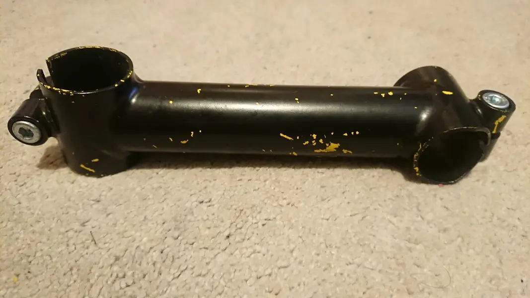

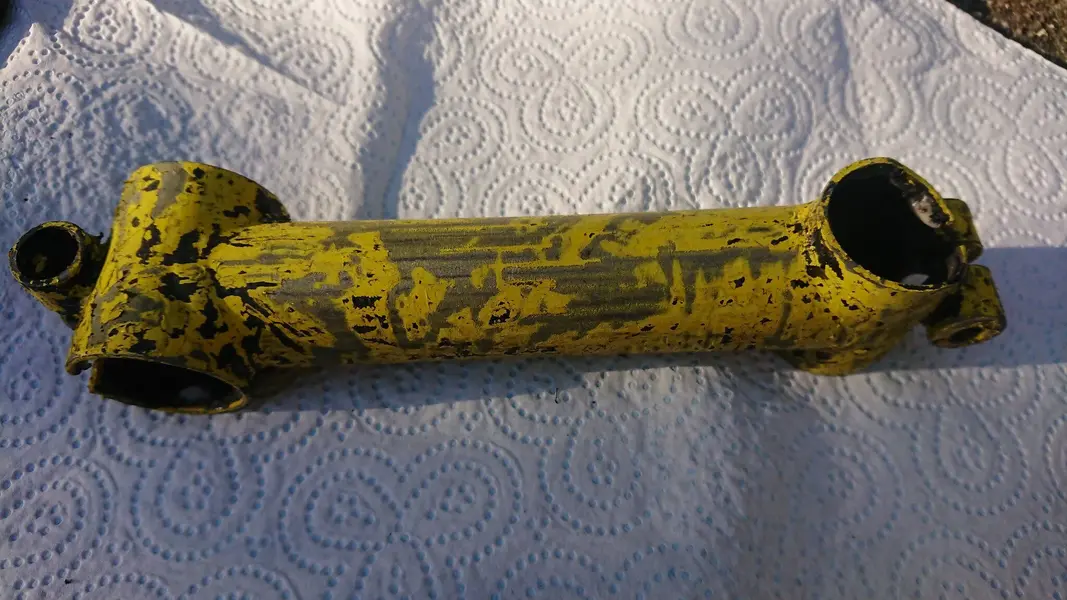

I recenty bought a titanium stem which had been paint and I have been trying to strip the aint. It went well to begin with, but the stem was originally a matte finish and I have got to a point where there are still traces of the yellow paint, but the most recent attempt did not seem to make any further progress. So far, I have used paint stripper with a stainless scraper, scourer and wire wool.
Any suggestions how to get the remaining yellow tint off? Or will I have to forgo having it bare ti and get it painted?

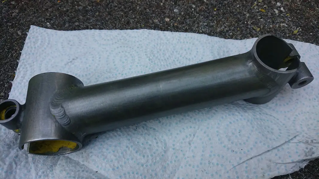

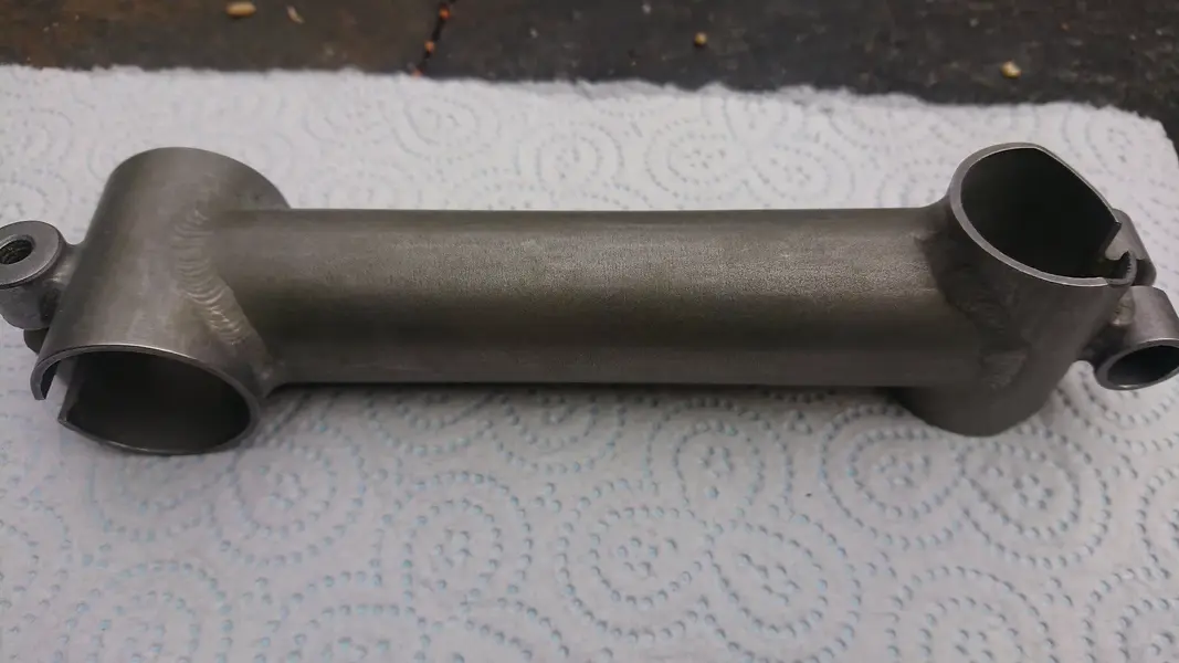

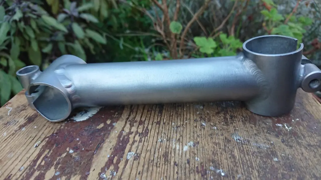

Well, having failed to make progress removing the nipples from the front wheel of my Ritchey, I decided to have a go with a brass wire wheel on this. No expectations of success, but a few minutes on the big wire wheel followed by a small one to get into the angles did the job. after that, I gave it a quick going over with a nylon wheel:
Thanks for all the suggestions. I'm glad to have made some progress. Now I just need to think about what finishing I want to try for.
