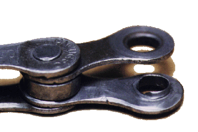

It doesn't elongate or get longer. The wear is all contained within the links, the pins and bushings wear, the rollers can then move further apart than they should. and the ID of the rollers also probably wears too.
116 links of old worn out chain should be the same length as 116 links of split fresh new chain.
Notice the groove worn in the pin, the roller being off centre and the edge of the bushing being worn.
