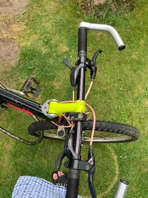

I shall be picking this up tomorrow morning: The front end of this reminds me of that old Mint Sauce cartoon with the oversuspended bike : "You can ride over old grannies and not even feel the tins of cat food."
Other than the front and and saddle it looks quite original.
The seller says it needs a service so it'll be interesting to see what it needs. Whatever happens it will receive new cable outers, saddle and anything about to drop off or kill me. I'll keep the ludicrous front end thoough ( and check the frame just in case the new fork/stem/wheels indicate a huge front ender in it's history.

The fork crown does't mach the fork lowers, I think. I'm not sure how, but maybe thats the problem? Or it is an indication, that something happened.
The crown looks like it came off of a Magxx, but the lowers are RS1.

True, should have bolts facing forwards.
Thanks for the observations - I am not completely au fait with RS1's - are the mismatched crown and lowers a problem? ( I will have to strip and service them in any case - they are locked.) there is no sign of a frontal impact - all the front end of the frame is straight and no signs of stress or cracking/wringkling.

You will need a ball needle and pump (like the Mag21 etc use) to fill the fork with some air. 50-60psi if I remember correctly. They should come up a bit further then. That should fix that funny look, I would hope.
If you want to put in new oil, they had atf transmission fluid in them, originally. 10weight fork oil is fine, too. Can't remember the fill height right now.
The mag crown shouldn't be a problem, I don't think. Originally they had a bontrager crown.

@grey-beard That is the correct pump. The crown is different.
You can see those crowns on switchblade forks of that time period often:
