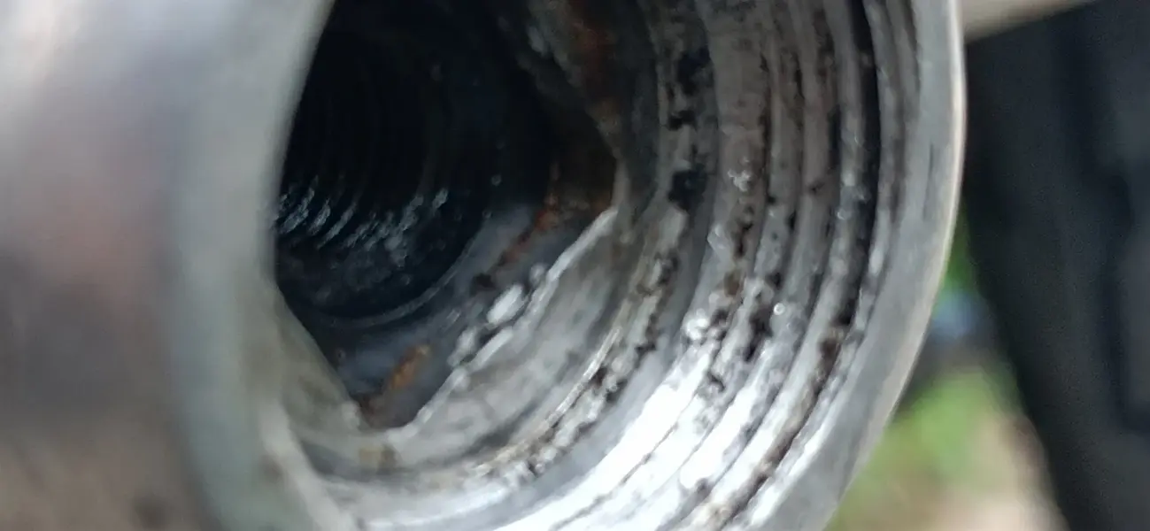

I've been given a mid 90's Giant MTB. It's in good condition but the bottom bracket needs changing. I already have the tool to remove square taper cranks but although the thread in the pedal doesn't seem to be stripped the thread on the tool looks way too small for the hole.
Were there different diameters for older MTB cranks.
Thanks for any help on this as I may have to cut them off if I can't find another solution.

I'm trying to remove the cranks from the bottom bracket and the removal tool doesn't fit the thread in the pedals. The bolt came out easily, just need to pull the pedal off the taper.
The only different size commonly around is French (21mm) whereas the normal one is 22mm.

Bit concerned you say way too small. Normally its pretty close to going in, or goes in and rips the thread out as it just catches but is actually 1mm too small!
Got a picture?
I'm sorry for the poor quality photo, lousy phone and an even lousier cameraman.
I've put a digital caliper across it and I get .876 inch or in metric 22.26.
I've measured the thread on the tool and its .855 on the outside diameter
Looking at the thread in the pedal it looks a much finer thread than the one on the tool.
