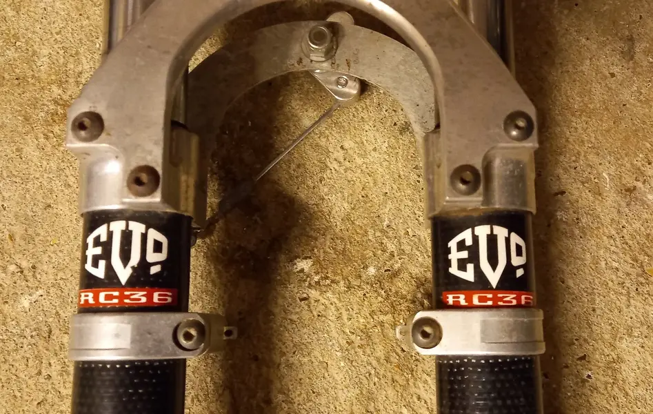

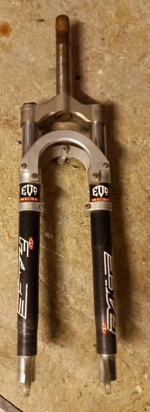

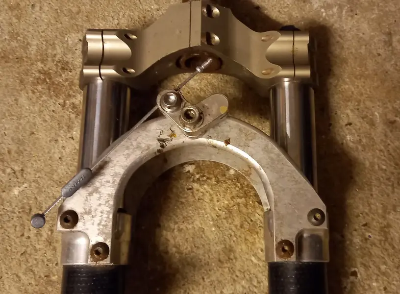

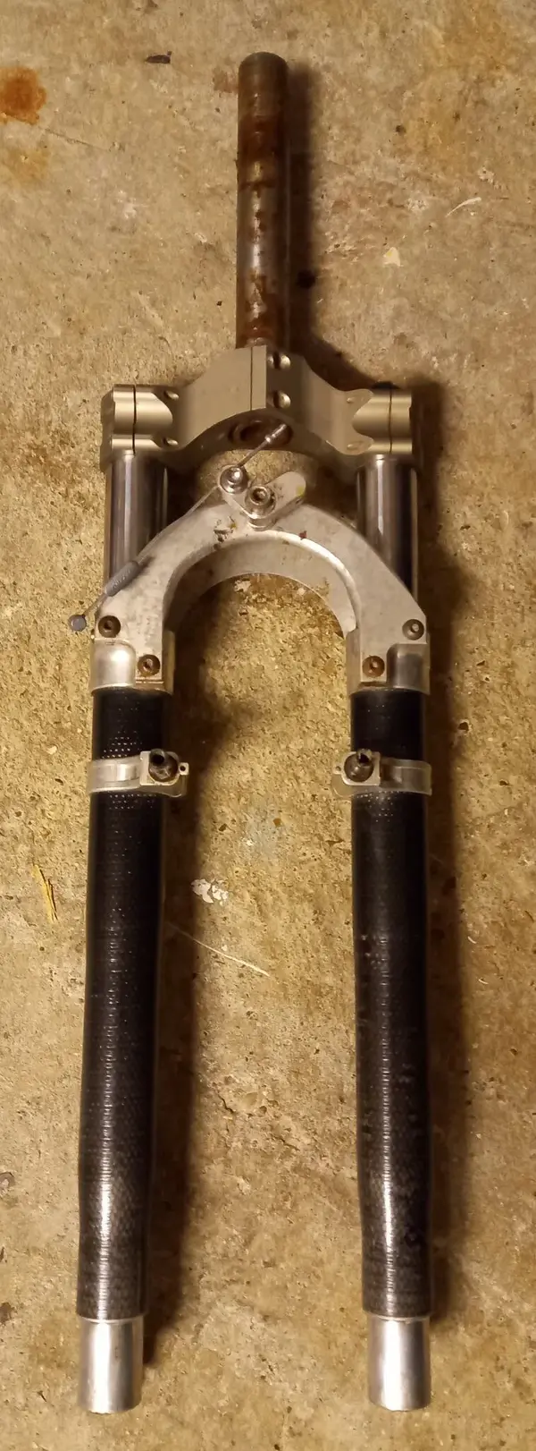

Hi all, I have these Pace RC36 Evo forks for sale they could do with a service to make perfect they have been modified to work with a cantilever brake, the steerer is 1in 160mm in length.
£75 posted UK Mainland only. 20221204_202221.jpg 20221204_202235.jpg 20221204_202249.jpg 20221204_202317.jpg
