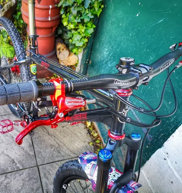

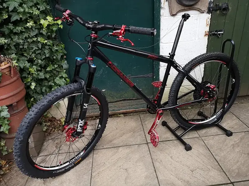

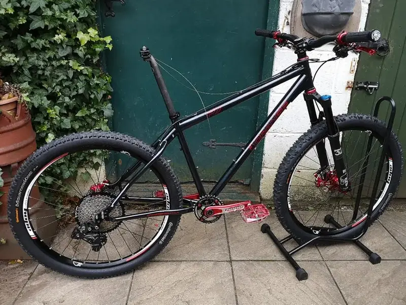

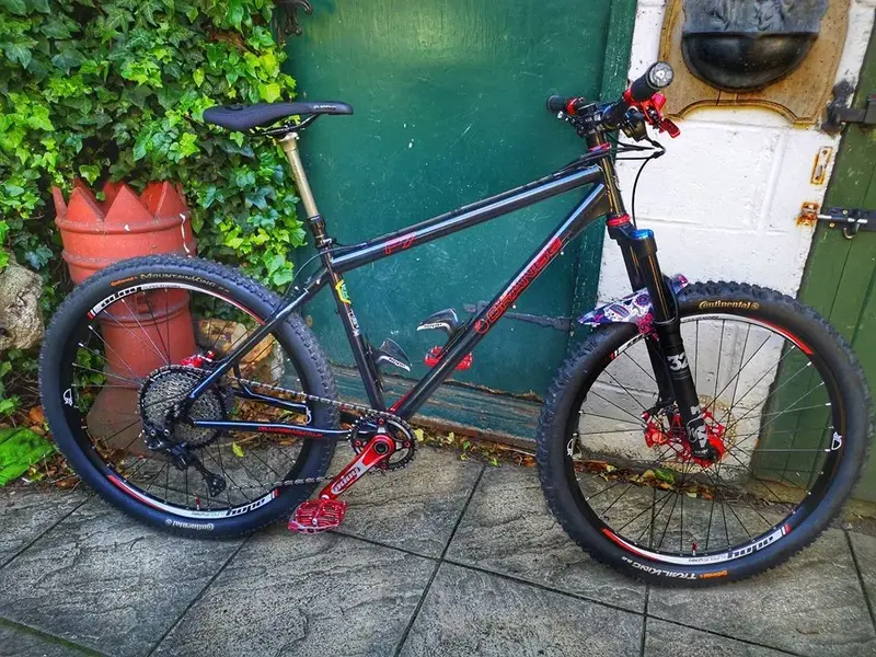

Finished at last! Delayed by last years ankle surgery & retro projects taking priority.

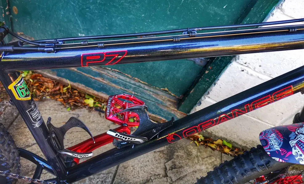

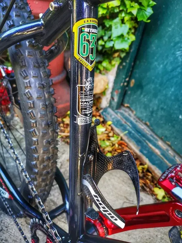

Frame Orange 2010/11 P7 17" Frame No: M10010171

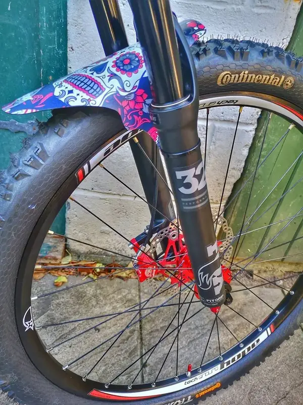

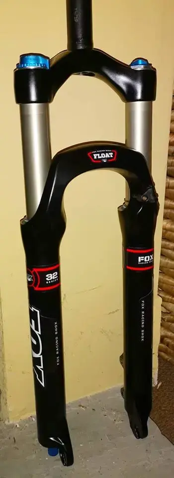

Fork - suspension - Fox2017 Float 32 120mm GRIP

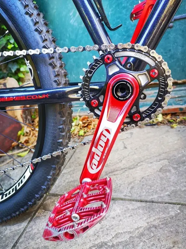

Front Chain Ring -
Hope Oval 34T Absolute Black 34T
Chainring Bolts - Wolf Tooth 7075 Alloy spannerless
Bottom Bracket -
Hope 30mm Bottom Bracket Shimano XTR BB93
Cranks -
Hope 170mm w/spider 68/73 - 140mm Shimano XT M8000
Pedals -
Hope F20 Shimano XT M8140

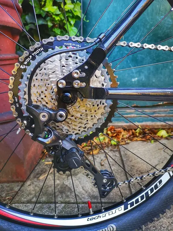

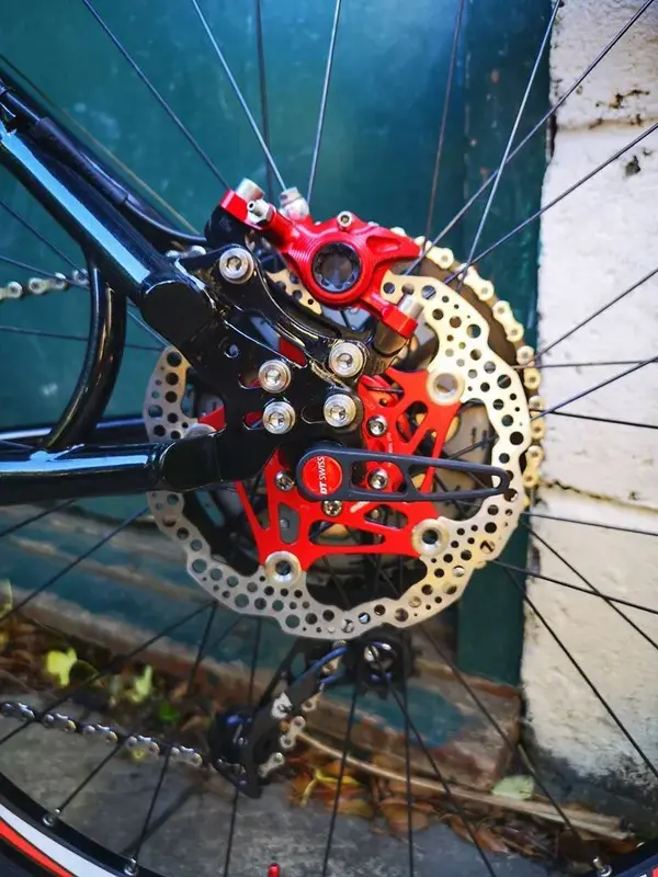

Cassette - Shimano XT M8000 11 Speed 11-42t Cassette (modded to 11-49t)
Cassette Extender - Wolf Tooth 49T Wolfcage kit
Rear Mech - Shimano XT M8000 Shadow+ 11 Speed Rear Mech
Gear Shifter - Shimano XTR M9000 Rapid Fire bar mount
Chain - KMC X11-93 11 Speed

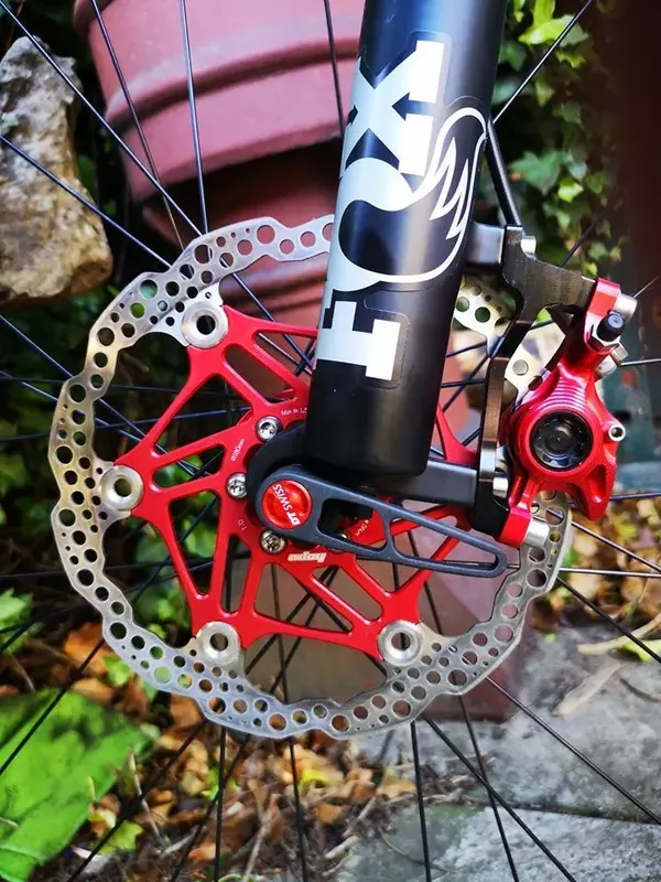

Brakes - Hope Tech 3 X2
Caliper Mount R - Hope Mount F
Caliper Mount F - Hope Mount L
Front Rotor - Hope 180mm Floating Rotor
Rear Rotor - Hope 160mm Floating Rotor
QR Thru Bolt F - DT Swiss RWS Thru bolt 9mm
QR Thru Bolt R - DT Swiss RWS Thru bolt 10mm rear
Hub adapter F - Hope HUB443 9mm front
Hub adapter R - Hope HUB239 10mm rear
Wheelset - Hope Enduro/Red Pro4 & Steel Freehub
Seat Clamp - Thomson 29.8mm
Saddle - SDG Radar. Hollow cro-mo. Orange edition
Seat Post - Thomson Elite Dropper 27.2mm
Dropper Lever - Wolf Tooth ReMote

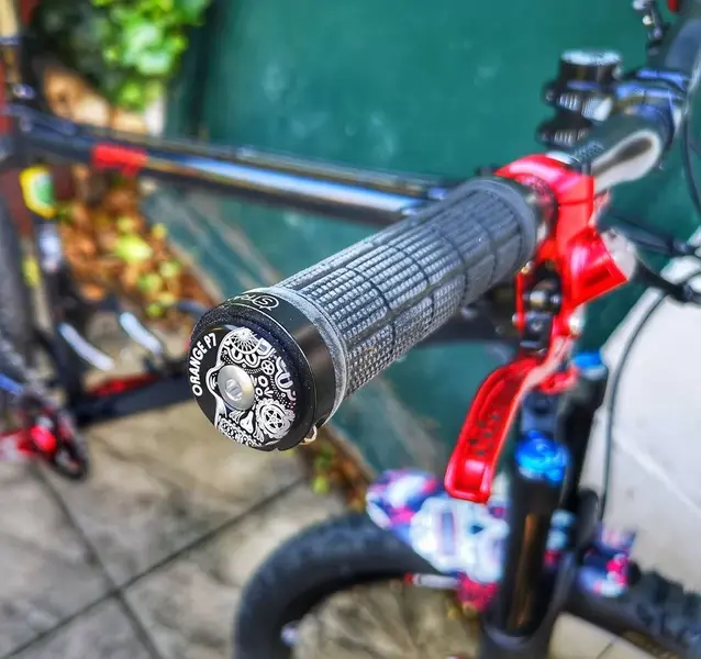

Grips - Orange Strange Grip 130's

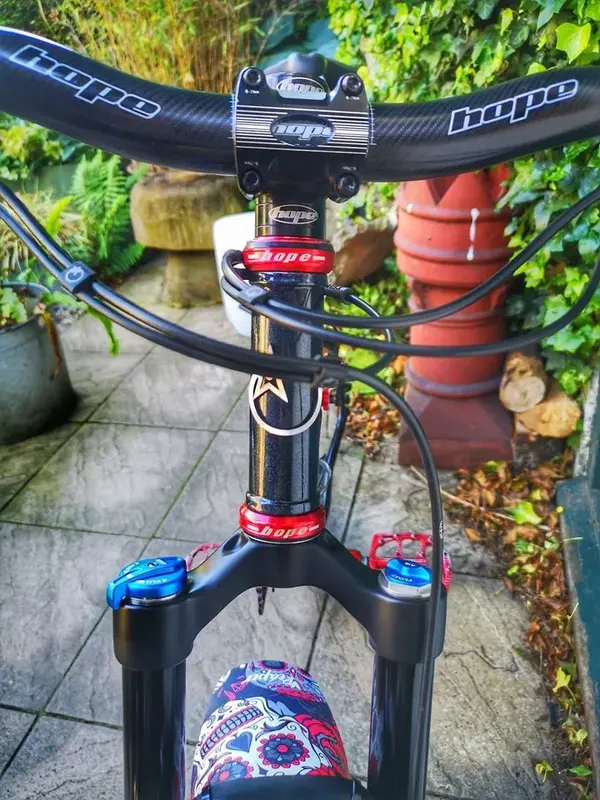

Headset Spacers - Hope Space Doctor
Head Doctor - Hope
Headset - Hope Conventional EC34 Headset - Red
Bars - Hope Carbon 20mm Riser 7° Back 5° Up 780mm
Stem -
Hope AM-FR 70mm, 31.8mm, 1.1/8", 0° rise - Red Thomson Elite 70mm 10° rise
Stem Cap/Bar ends - Kapz Custom plus Ti bolt
Bottle Cage - Hope Carbon Fibre
