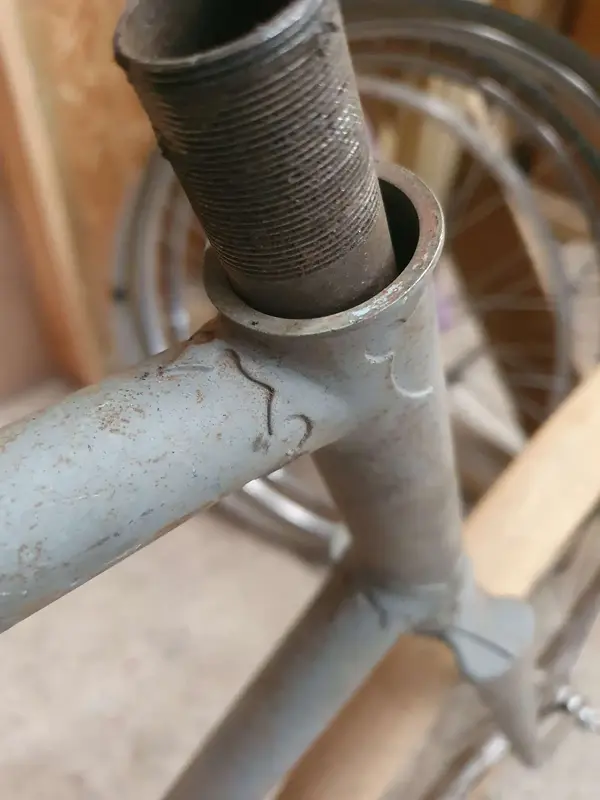

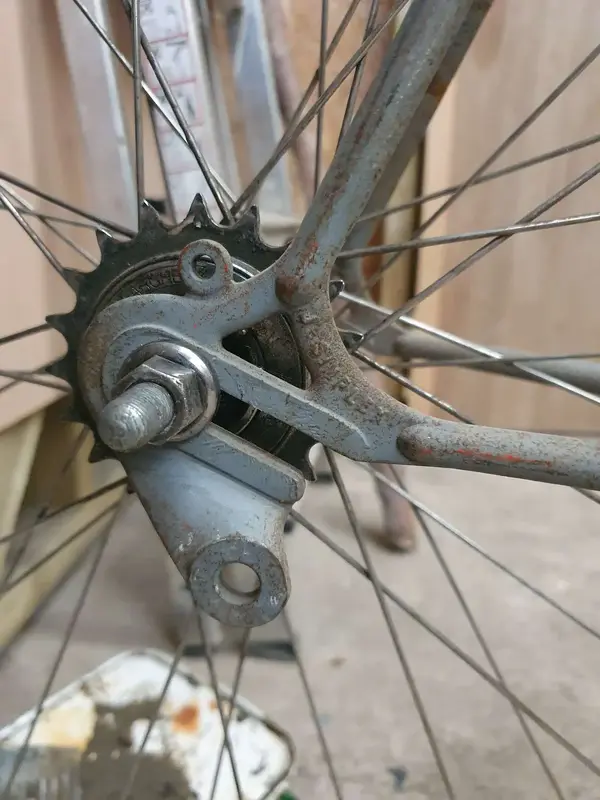

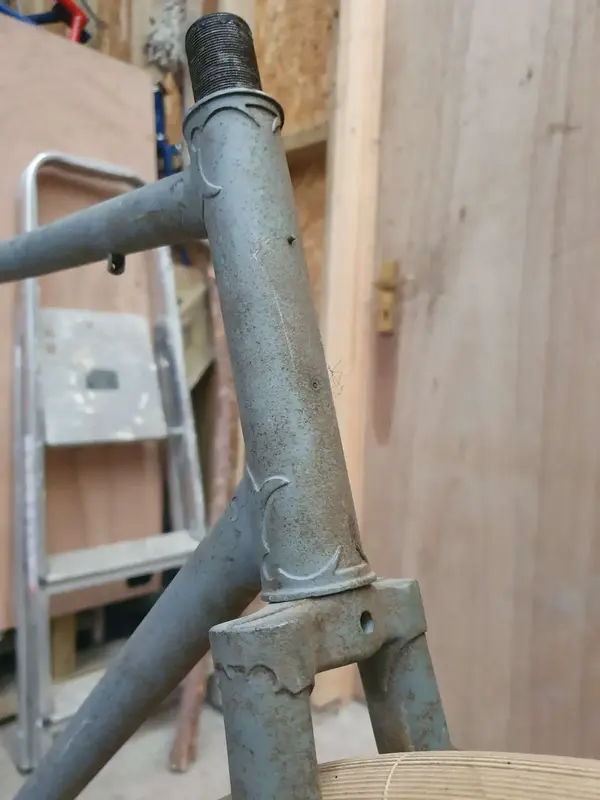

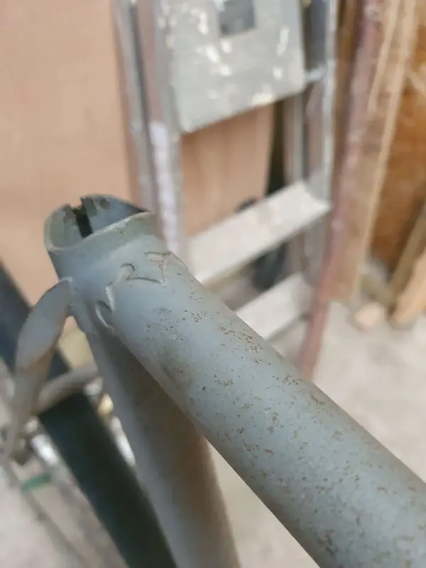

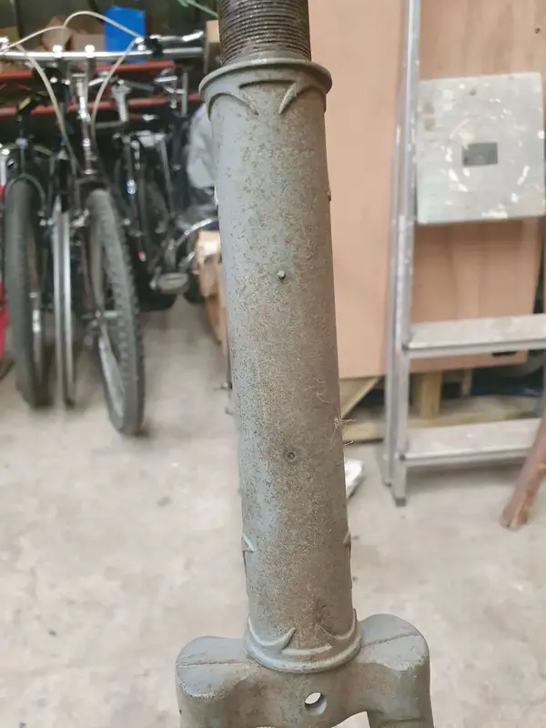

Hoping someone can help identify this lovely presumably 50s frame. Nervex BB and modified, filed Nervex Lugs. Simplex dropouts. British threads. Frame number c1323 (non drive dropout and steerer). Any ideas? Thanks! Compress_20220822_145836_6125.jpg Compress_20220822_145835_5103.jpg Compress_20220822_145835_5471.jpg Compress_20220822_145835_5817.jpg Compress_20220822_145834_4169.jpg Compress_20220822_145834_4426.jpg Compress_20220822_145834_4781.jpg Compress_20220822_145833_3919.jpg

The reason very few builders used the crown was because it was obviously welded, cast crowns were the thing then.
Having pulled many bent cycle forks in the 50s I can vouch for the strength.

If you haven't already seen it, here's an article on Nervex lugs: https://www.classiclightweights.co.uk/classic_builders/nervex-professional-lugs/
Yours are the earlier type, so the frame is likely early 50s rather than mid or late 50s.
I think the spearpoint on the tops of the lugs is not standard. Someone like Keith would have to confirm because Nervex lugs are before my time and I'm not 100% familiar with them. If that's the case, the spearpoint is going to be your clue to the builder. Unfortunately, it means trawling the frame builder's section of the old Classiclightweights site until you find which builder used to add the spearpoint to their fancy cut lugs.
